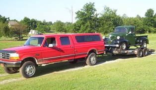

I sold trailers for several years, and have about 125K miles of hauling cars and trucks through 34 states. I'll tell you what I have and how I use it:
Trailer: 19' long (16' deck with 3' dovetail) with two #3,500 axles. Frame is 5" C-channel with a wrap tongue, which is a tongue that wraps under the frame and continues back to the front of the front spring mounts. Crossmembers are 3" x 4" angle iron, spaced 20" apart. Wheels are 15"x5" steel modular trailer wheels with 700-15 eight-ply bias trailer tires, with #1,875 capacity each. I have brakes on the rear axle only, but many states and provinces require brakes on both (which I recommend). The lighting is standard DOT trailer marker lights with LED taillights, and DOT reflective tape. Ramps stow in the rear (recommended) with lockable stowage doors. The deck is wood, and the dove is 3/16" diamond-tread steel. I have a Braden #5500 electric winch, which had pulled up on the trailer any vehicle I have hauled, with ease. Tie-down points are four D-rings (one on each corner), and the front cross-bars can be used, as well. My trailer weighs #1,850 tare (empty), and is #7K GVW. Coupler is a 2", #10K Bulldog unit. Trailer jack is a #10K Redneck brand adjustable unit.
When I tow, I use the winch cable on the front axle or crossmember, and ratchet straps with axle straps around the lower control arms or through the wheel slots, depending on what is being hauled. NEVER TIE DOWN using the vehicle frame as a tiedown point!!! The towed vehicle WILL bounce, no matter how tight you think you have it down, and you'll regret using the frame as a tiedown point. I use two ratchet straps with two axle straps on the rear axle, as well as a logging chain around the rear differential, all anchored on the rear D-rings. Wheel straps can be used if you have a proper point along the siderails of your trailer. You see cars attached to tow dollies all the time, that is what you want yours to resemble, if using wheel straps.

That includes the spare tire/wheel, chains, straps, ramps, battery for the winch and the brakeaway kit battery. I've hauled a #6,100 '53 Dodge H-H-A flatbed truck on it without issues. THAT was pushing the design limits for the various components, but it did everything it was supposed to do superbly.
As far as with or without a dovetail, that is pretty much a personal preference, along with what you plan on using the trailer for in the future. I've hauled 95% cars/trucks on mine, but have hauled tractors, sod, flagstone, and lumber with it. The dovetail really wasn't a hindrance in any of that. If you plan to haul cars on a regular basis, you'd be better off with the dovetail, as this keeps your vehicle that you're loading from bottoming out on the back edge of the trailer while you are loading it. If you plan on primarily hauling stuff (logs, lumber, snowmachines, sleds, etc), you would benefit from a straight-deck trailer.
