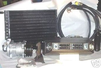

I don’t want to highjack this thread but if I have nothing now, what would be the best bet for some type of interior cooling? I survived last summer sitting on ice packets. I was going to go with a bee catcher but I don’t think I could get it to mount flush with the top of the window as our doors have a nice curve to them. I guess I could fabricate some kind of an adapter.
Are these ebay auctions for a full A/C kit worth the price?:
http://cgi.ebay.com/ebaymotors/57-58-59 ... 29fd76e56c

Post by JimE »
The price sounds about right, 2/3 of what I spent was on labor. Jim
