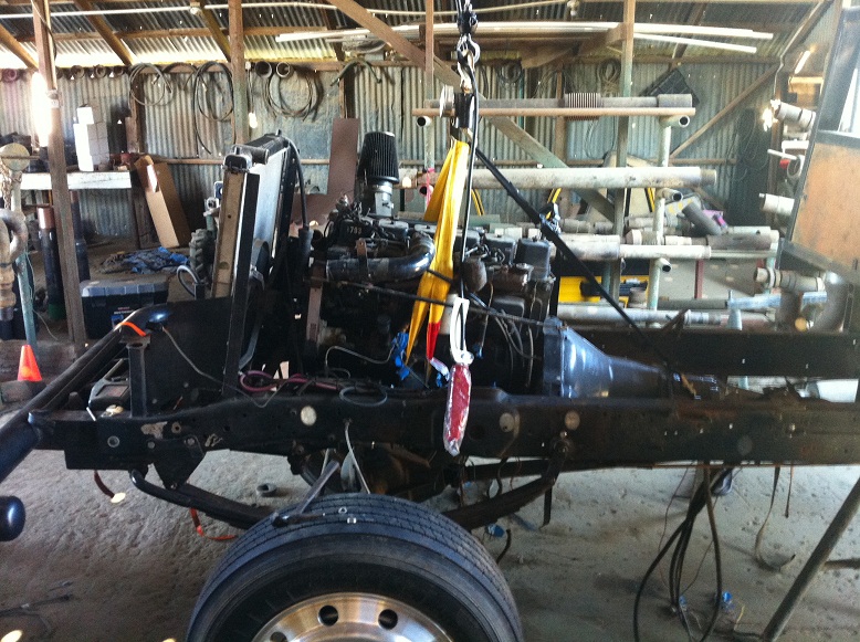

I suspended my engine in place exactly were I wanted it then built the mounts to the frame. You need to fab a cross member between the two mounts also.
Don't have a picture of my engine cross member but it's simular to the tranny but it's bolted inside the frame rails. I'm sure if you search you can find lots of pics on this site.
