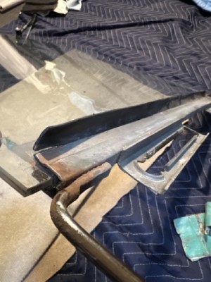

Oh that's a bummer...I'm looking for the same rubber part.
FYI, it's more than just a way for the glass to fit in the frame, it also sticks out on one side. See pic below.
Anyone have any replacement ideas?
I called around Steele and Roberts with no luck but R's said that the Chrysler number for that part was 1561415
thx!

I've looked high and low for the window regulator (aka: Channel Seal) seal that also has a lip like it was from the factory. I even looked through lots of home window seals but have only found one possible solution. It's a window channel seal from a classic ford parts dealer called Bob Drake.
https://bobdrake.com/products/1932-38-g ... 81c5&_ss=r
Now the question to the experts...was this window channel seal always just friction fitted? I don't see any evidence from my old seal that there was ever channel tape used. Channel tape was used on many classics cars, it expands shortly after installation and works as both a seal and an adhesive to keep the window tight in the regulator.
Thx!
-W

mnwebb wrote:
Wed Jan 15, 2025 6:06 pm
Was said flap onthe outside? Just guessing, but I have half a hunch that the rubber piece that holds the glass in the channel starts life as a flat strip of sheet rubber and takes that bent shape over time when pressed up againt the mating lip seal on outside of the glass. There are two such seals (one inside and one out) clipped to the downward steel edges of the door. Said flap may even have folded over when the window is all the way up thus making a hokey seal against intruding water. Wouldn't want very much water there as ice might then lock the window in place.
Just a thought.
