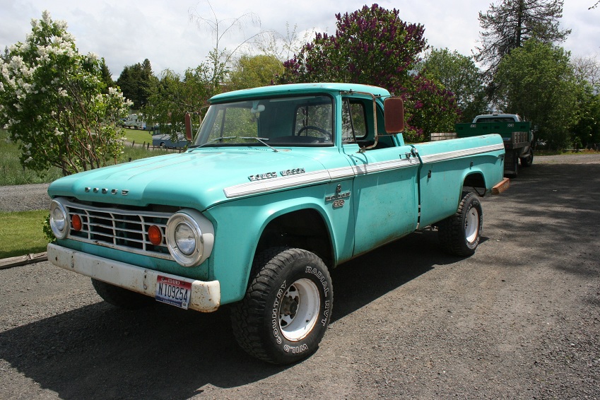

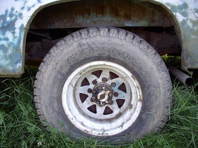

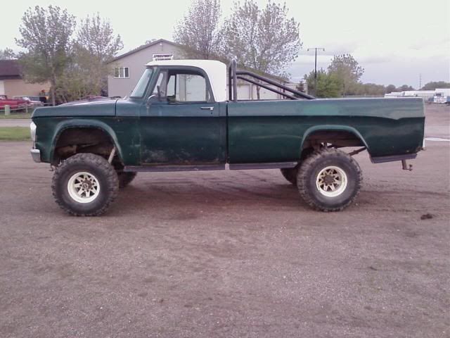

I have some 15 by 10's on my power wagon, and 16 by 8's on my half ton power wagon. I also have a set of 15 by 8's that are not on a truck right now, I ruined one of them, 4 inch backspacing is what they are.

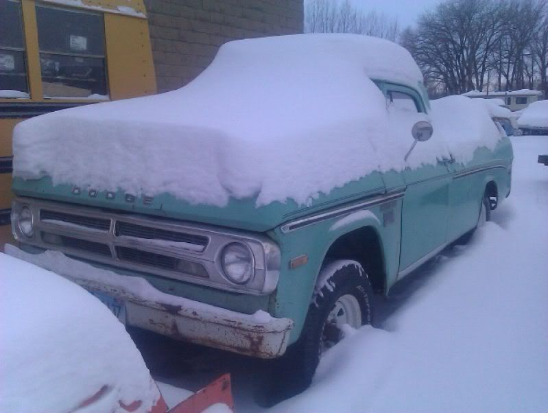

too much snow in this picture, but it is all I have of the 16 inch combo'd truck....

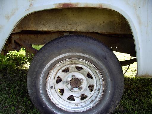

here are 16s on my step dads 73 Power wagon and 15s on my 65 sweptline.
Re: pic request: White 8 spoke "wagon" wheels
huh, I kinda thought that 15"s would not fit. by the looks of it they will. Thats a plus, I can still (for now, but its getting harder) find cheap 15" tires and that will keep the wife happy! thanks for the pics!
