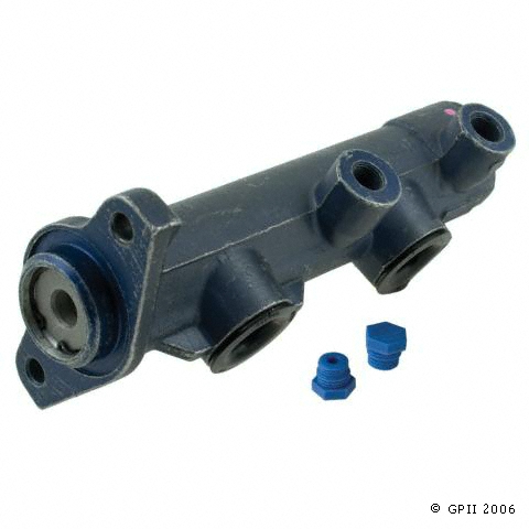

I'm running a Raybestos two bolt aluminum master cylinder meant for a ~'85 Dodge B150 van. Sounds like you already have the 2 two 4 bolt adapter. No vacuum booster, no hydro boost; just my foot, the master cylinder, and 4 drums. Clean and simple, just how I like it. I think I paid like $35 from RockAuto.
Re: brake master cylinder
Thats true this is the remanufactured one for $35

I found one from a 85 dodge D250 that is very close to bolting up to my mounting brkt. thanks for all the help guys.

muddyoldman wrote:I found one from a 85 dodge D250 that is very close to bolting up to my mounting brkt. thanks for all the help guys.
Yeap, thats the one I put the picture of :Thumbsup

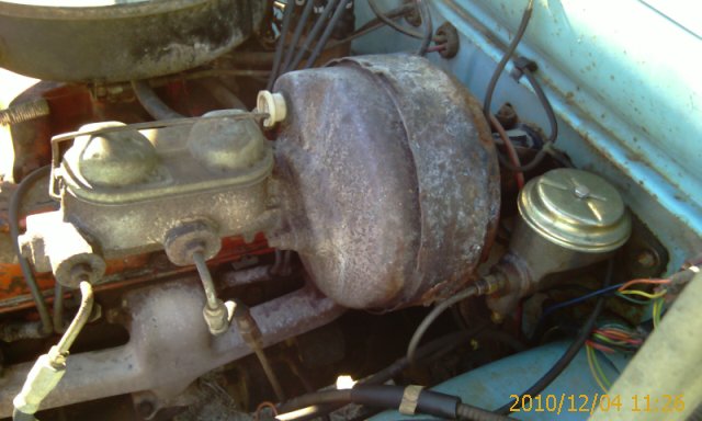

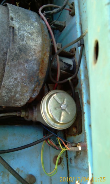

Mine came to me with a dual-line master cylinder so I can't say what it's from. Here's some shots of all that stuff.

elacruze wrote:Mine came to me with a dual-line master cylinder so I can't say what it's from.
Looks like the stock set up to me.
Could be, I don't have any reason to believe it's been molested. I thought it unusual that the lines from the master are rubber hoses, and I have no idea if a dual reservoir is standard in '68.
