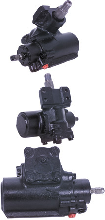

I have been doing a bit of digging on this lately and things are looking promising!
Here is what I have found so far:

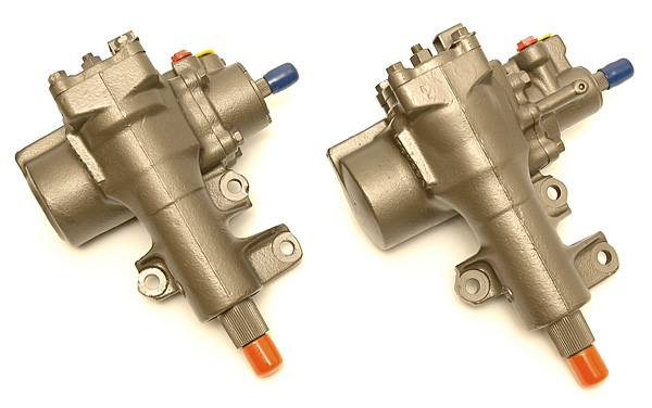

The 82-85 box seems like the most direct fit. This could go back as far as 79 and
sporadic use up to 87. I have had conflicting info. They are very easy to tell from the
IFS steering boxes, which are almost 2 feet long. It is close to the same size, and the
same orientation - Doesn't mount upside down or on its side.
It is a bit pricey over the counter.
Notice in the first picture it has a funky pitman arm.
This is what I had heard was a major stumbling block.

If you are out to be adventurous and interested in a cross steer system,
the IFS box might be a good candidate. It mounts on the out side of the
frame, like the later Dodge's. However, it puts the steering shaft closer
to the frame, than the Lifestyle trucks. It is also has a long profile, keeping
the input shaft and main body above the frame, rather than beside it.

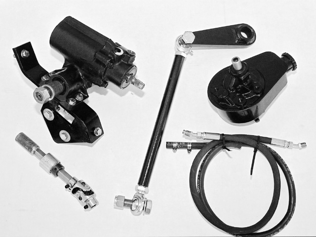

Re: Toyota Steering Box Research
does the box look like this?

Robin- That looks like it. Is that a kit someone offers for another vehicle?
Looks like everything you would need!

I have to agree, welding will be just fine :Thumbsup There are a couple of others who have done the exact same, top from the toyota and bottom from the Sweptlne.
nfury8, yes thats the exact box, only with everything offered is for the ferd or chitty, if you change it over now you'll be happier and it will be easier :study

here is a guy that sells kits on ebay "steeringsupplyguy"
Do you remember this? viewtopic.php?f=20&t=14267&p=97054&hili ... cts#p97054
You've been down this road before. The kits run about $500-$700.
