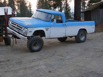

38" swampers are going to be considerably bigger and harder to fit than 37s.
Re: Minimum lift required for 38" superswampers on W200
Same width, 1" larger in diameter and just more aggressive tread. Can't be that much bigger.
I need to replace my brake wheel cylinders soon and will fit the 38's on at that time and take more pictures.
The biggest item that will be different than what you see is I need between 2"-3" spacers for each. I think 2 1/2" will be correct, but need to try them for steering linkage clearance.

Those 37s probably run an inch undersize and the swampers will be true to size or bigger. They'll rub turning/offroad.

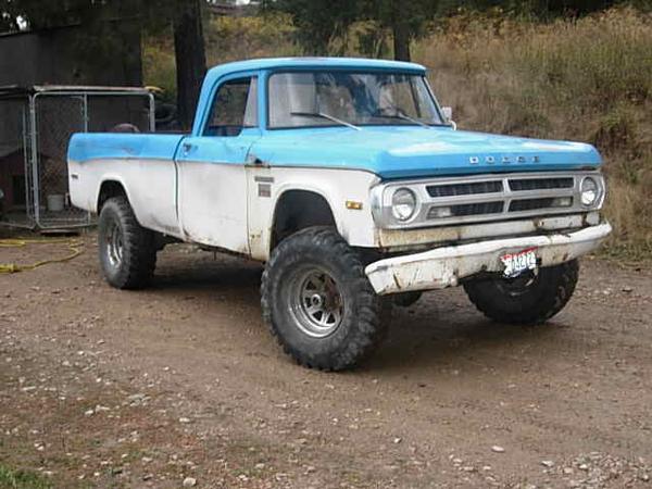

here is a pic i snapped in the bone yard today. this was a w200 is this a normal spring setup? looks tall.
also SPESPC in your second pic behind your rear tire there is a factory multi hole bracket. does anyone know what that was for ? thanks
- Posts: 152
- Joined: Tue Mar 31, 2009 6:34 am
- City: belleville,il.
Springs are definitely not factory W-200, and the bracket is for a spare tire carrier. On those springs, I'd say all the square cut leaves were added to the original tapered leaves. Doug

Good to see. I have some 37 inch Goodrich tires to go on my 1970 W200 crewcab this weekend or next. I was under the impression they would go on in stock configuration. It has the original Denman bias ply now. 36 inch I believe.

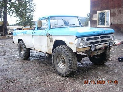

Well I have to be honest. I did trim the front fender. The 37"s have no problem and have not rubbed to date (only 100 miles at 40 mph).
