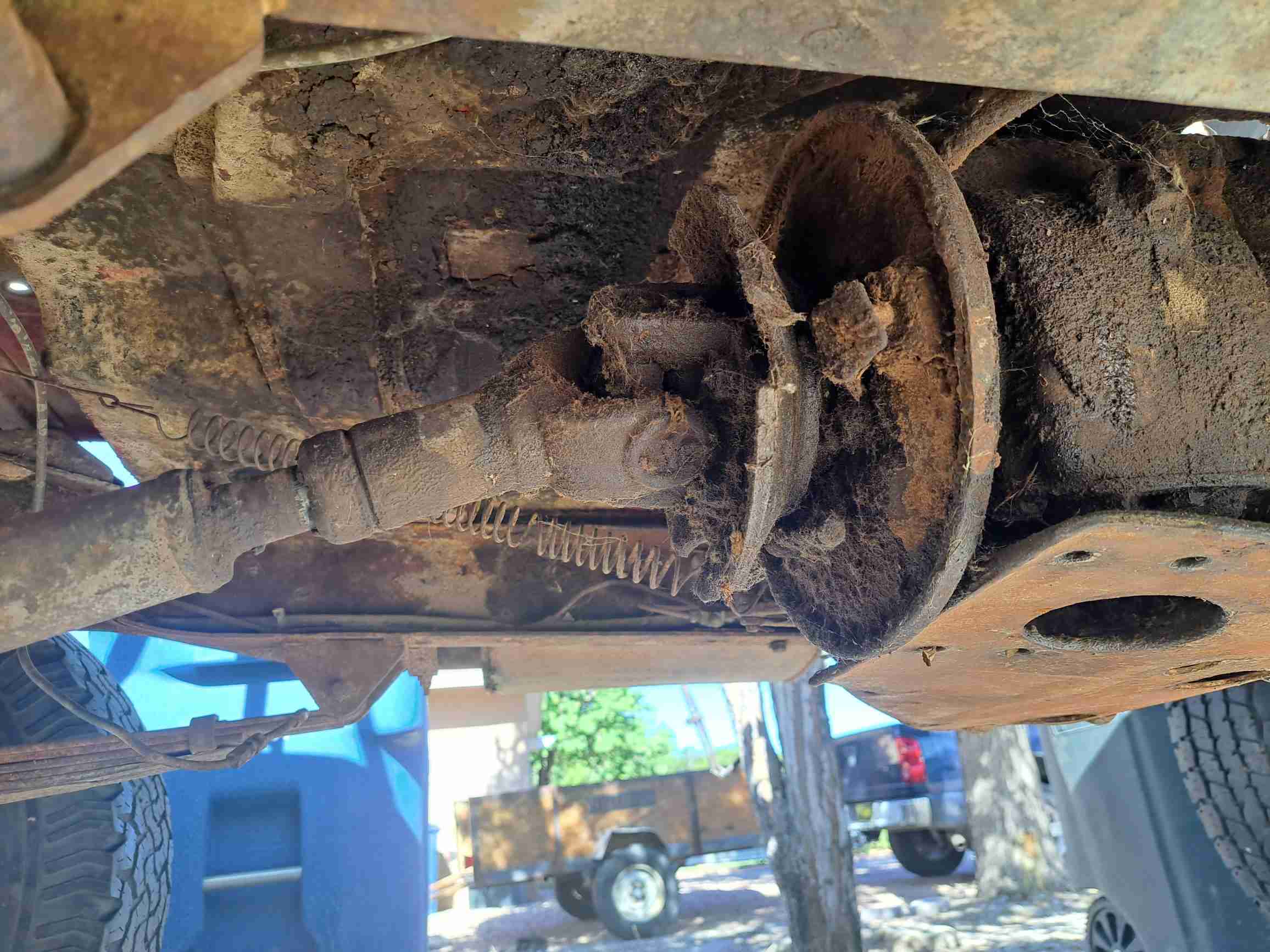

There's some kind of driveshaft E-brake on the back of the T-case. That's why I think it's not original CJ. Not that I know this for sure. Would a Jeep trany and T-case bolt to a 318?

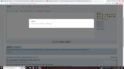

Still can't load pictures. I'll try to load a screen shot of what error message I keep getting........
OK, why did the screen shot load and not the pictures

The screenshot file was small enough to load. I gave you a link above to a lengthy help thread on how to post pics and what you are doing wrong. GO READ IT!

Ok,
Just practicing adding images mostly.
But here a shot of the rear of the T-case
