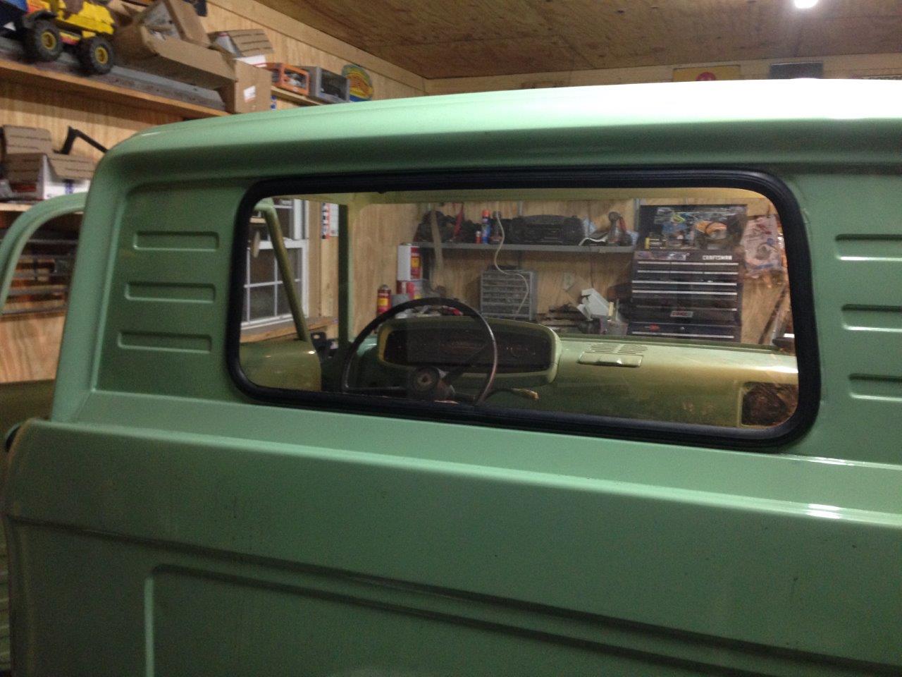

Re: Small rear window gasket install Done!
It is done!!!!
. Thanks to kurt about the box in wrench for the lock strip.
I used an 8mm and it slid right in. Corners were tough. I watched a couple of videos on youtube. I tried the rope trick yesterday from the top but, I was on the outside. I already got the gasket on the window yesterday by soaking it in hot tap water. Soaped it up with Dawn. Shop is heated and 500 watt spot lamps keep everything including me toasty. Put gasket on two long corners and one short, stood it up while daughter held it and just pulled up over last corner. It went on surprisingly easy. Today I enlisted my 29 year old daughter, she owed my for helping get stuff from her storage unit. Of course it was the last tote in there. Anyway, I had her push in on the glass and I roped top down from the inside. No luck. I did it bottom up and the glass and gasket wanted to roll out. After the gasket was in I just pushed on the glass and it moved up and went right into place. I had to soap it down and worked center out to corners to get it coverage. I just used the rubber handle on a hammer. Like a rubber or plastic hammer. Thanks guys.
