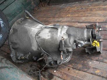

Dont u need a special short trans to fit in front of the t-case?

Here' a pic. of a BB 727 short tail.It came out of a 76' motorhome. They will fit in front of the T-case. Paid around $200 for it.
Chris
*Edit: Short shaft tail is 8" long. :Thumbsup
