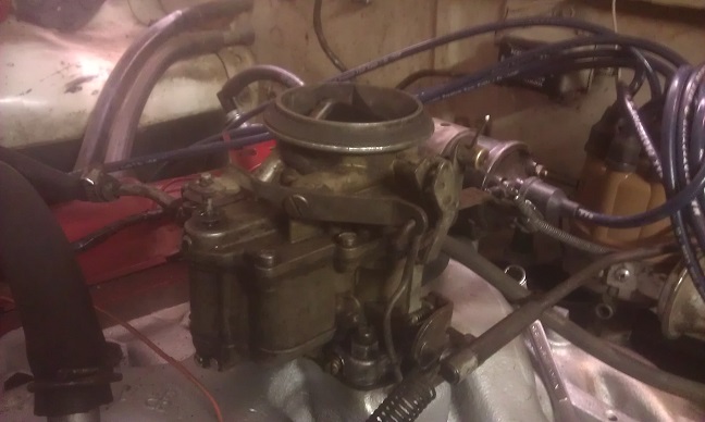

Title pretty much says it all, I'm going to do a gasket and seal replacement on my Stromberg WW 2bbl carb. I'm doing this because the thing was puking fuel from the upper and lower seals (not the seals where the carb mounts to the engine, replaced those earlier). I've got a kit courtesy of Mike's carburetor parts, and the instructions that came with it are pretty good. The carb itself looks pretty simple, it's definitely not as bad as a distributor pump (screw those things). Still, it's my first carb overhaul and I was wondering if you guys have little tips or tricks you've learned through past experience that could save me a potential headache. FWIW, I'm not going to be getting to this for a few days, I'm still chasing gremlins out of the ignition circuit.
Here are a few pics for reference, thanks!:

The offender.
The offender.

So, the carburetor itself wasn't particularly hard to overhaul. It kinda runs, but I found a problem that I don't see an effective way of fixing. Check the pic out, I found another leak around the throttle valves behind the linkage. I'm fairly sure there's a bushing back in there, but since the linkage is brazed on I really don't want to mess with it.
I went to the Holley website, they recommended this carb: http://www.holley.com/0-7448. Anyone have experience with this particular model?

I actually found a local guy that has experience with strombergs. He quoted me $90 to replace the throttle linkage bushing and flow test it. I'm gonna give that a swing, as this shop seems pretty legit. I'll keep you guys posted though.
