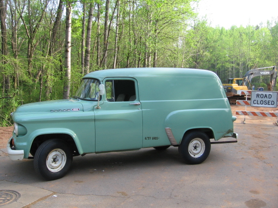

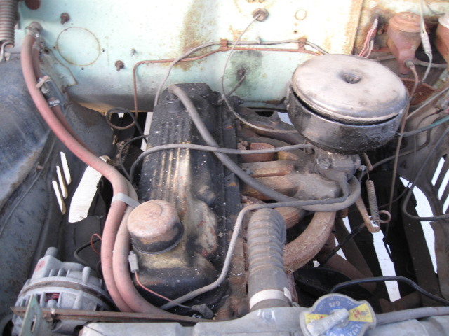

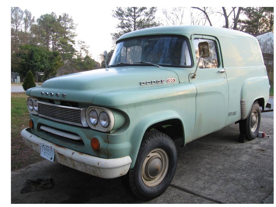

After draining and rinsing the fuel tank, changing the oil and adding fuel filters before and after the fuel pump I tried starting it, and after a few tries it fired up and idled great. I actually drove it a few feet into the garage. I plan on replacing most everything rubber (hoses, seals, fuel pump, water pump etc). I plan on doing power disc brake conversion and replacing all the rear brake parts and hard lines.

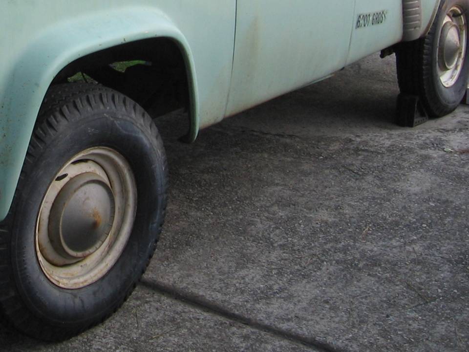

This brings me to my question, I want to keep the truck as stock as possible with the exception of the disc brakes. The stock wheels will not fit over the calipers so I will need to go to a slightly wider wheel (ie 6.5 inch wide ). I know there are a lot of options that will fit such as 70’s Dodge trucks, full size mopars, Ltd’s etc, but I want to keep the stock hubcaps. The car wheels seem to use a slightly smaller diameter cap. I plan to go to the Pull A Part this weekend and I can just measure lots of wheels , but I thought if anyone knew of where to start it would be helpful.
Also any suggestions about pitfalls on getting a vehicle that has been in storage this long, back in usable condition would be appreciated.

Sorry... I don't have any answers to your questions... but I wanted to say how NICE your panel truck is!! Good Deal!

wow nice. I'd be tempted to NOT swap to disc brakes and use some vintage reproduction bias plies. You'll be fine in most situations if you have nice soft shoes and good hydraulics in the brake system.

Wow that thing is a time capsule. Very nice. Have you looked into custom made wheels? Or it may be cheapest to find another style dodge dish that you like. Good luck.
Re: Need Wheels for my new project
Nice original trucks like yours are getting hard to come by. I wouldnt change the brakes or the wheels...I'd keep it as stock as you can. Just completely go through the brake system with new shoes, hardware, wheel cylinders etc etc and the truck will stop just fine. Put the money you were going to spend on disc brakes and wheels into a restoration of the mechanicals of the truck and you will have a really fine original panel truck. "Restored and modified" panels are easily found....original trucks are much more rare.

The stock 15" & 16" 5 lug wheels that take the larger ~10" diameter
dog dish were 5.5" wide and I've never seen one any wider. You might
check into some 5 lug ford wheels.
Also, as Doug mentioned,
you might look at Stockton Wheels to see what they could do for you.

Thanks for all the replies, I am going to rebuild the drum brakes on all four wheels and see how it stops, I do want to keep it as original as possible.

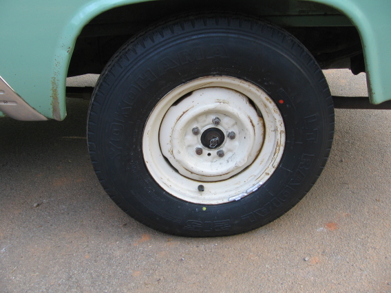

Well I have opted to stay as original as possible with this truck, I went through the brakes and replaced the master, shoes, and all the hardware, hoses and had the drums turned. The brakes work very well and I will give them a try for a while before I decide whether to go with disc brakes. I also decided to stay with the original size 7.00-15 tires I like the old time look of a skinny tire and they also make turning when going slow a lot easier that with a wider tire. I did make a concession and went with a radial tire, after a lot of looking I could only find one 7.00r -15 tire it is made by Yokohama.
I got the tires mounted yesterday and finally got to take the truck for ride of more than two blocks from the house and over 20mph. I drove it about 10 miles and it drove great, hopefully this weekend the weather will be nice and I can get some more miles on it. I’ve been going through lots of polish and wax trying to bring back the original paint, the paint is a little thin on the hood but elsewhere it is shining up well.
The Yokohamas are light truck tire, Load Range D, 8 Ply Rate and have max inflation of 65 psi – any suggestions on what pressure I should run them at, 99% of the time the truck will be empty. I currently have them inflated to 45psi and they ride good until I hit bump or pot hole.attachment=0]IMG_1342.JPG[/attachment]

If you do end up going with discs you may be able to get away with some factory swepty 16" wheels. I've had 'em on several of my past d100's '61-'71 and they have the same bolt pattern as your panel, and accept the original hubcaps currently on your rig. Plus you can run some 235/85/16's which are a bit taller than a 7.00x15, netting you a bit better cruising ability. As for your new yoko's I'd aim for about 32-35 psi. Should improve the ride without losing any handling quality.
