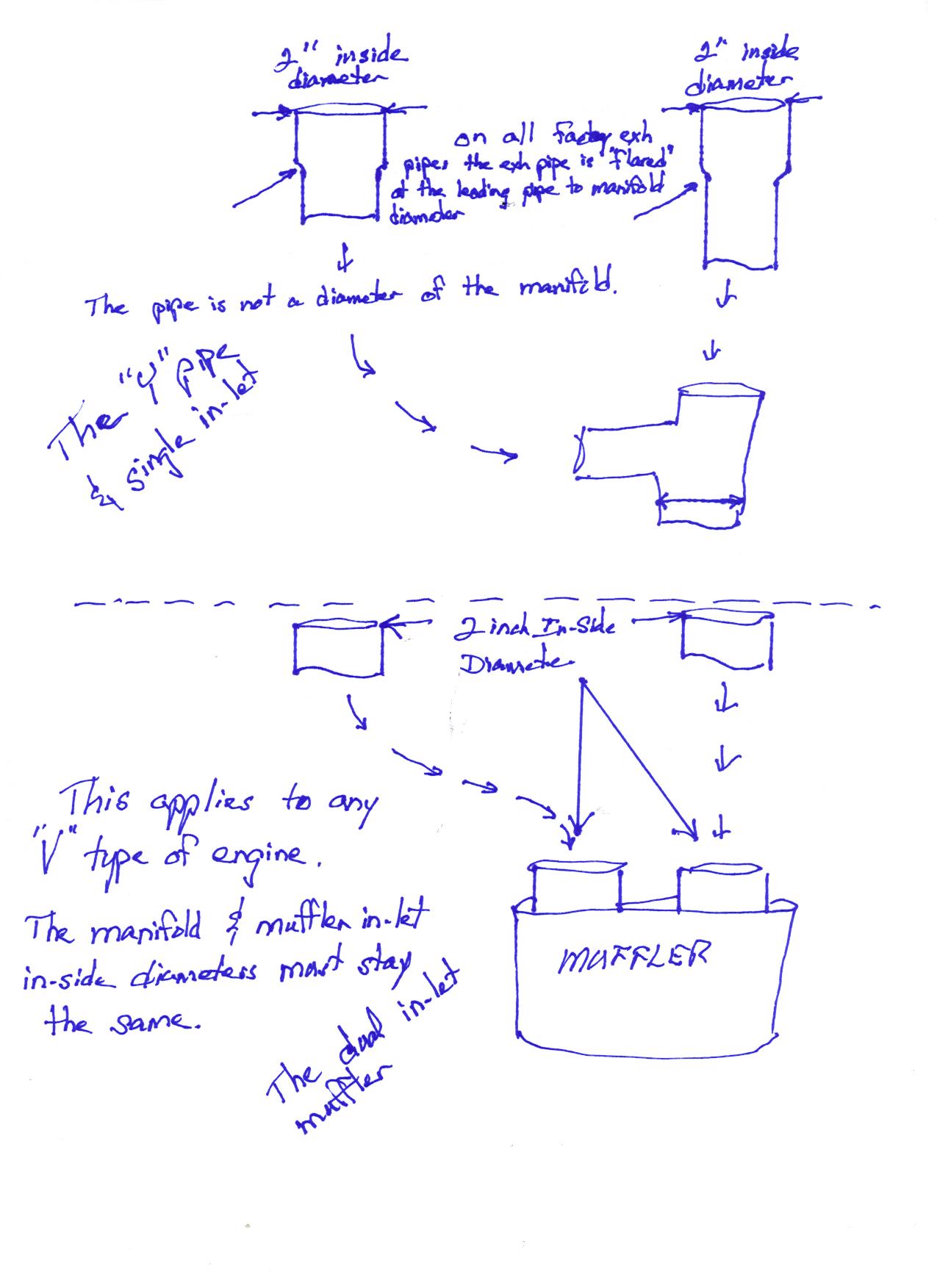

I'll start with the Routing Part.
Every Muffler Shop has a picture book on what the routing was/is.
Exhaust Pipe Diameter
In the beginning the Engineering Department Team figures out what
the best diameter should be. Later in the process the "Bean Counters"
say to the Engineers, "... We can get a smaller diameter for a lower price,
what can we do about the size of this pipe?" . The Engineering Dept
replies by saying if we do use the small diameter it will cut _______
power from the engine. The smaller pipe is used to cut building cost.
The build order is to have the smaller pipe and to "Flare the End" to
match the Exhaust Manifold Size.
For any Performance Reasons the build order is to have the orignal
diameter. This means for you to have the same diameter from the
Exhaust Manifold to the In-let of the Muffler. The Out-let from the
muffler ( aka Tail Pipe ) should be a smaller diameter than what went
into the muffler.
The reason for the smaller diameter is that at this point in travel the
Exhaust Molucules have cooled off ( shurnk ) and the same diameter
is no longer needed or required.

Re: Exhaust System
It is not a photo of "pictures" it is much as the Electric Diagram for the
wiring. It will state the OEM pipe diameter and the muffler information
for all design's and version's.
Your Truck only had the Exhaust Routed on the right side ( passenger side ).
The "y" Pipe goes to the Right with the Muffler under the Cab.
From the last CSS/HPP's there has not been a Under the Vehicle to the Rear
Bumper Dual Exhaust Dodge Truck. But ... the Exhaust Designed Routing
Designrd Space is still there.

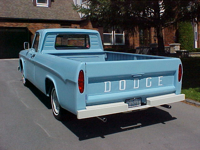

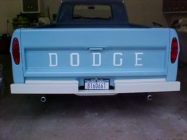

Re: Exhaust System
I had mine custom made at Cole Muffler. (Waterloo, NY). It has the 225 slant six. They "Y"'d it off the muffler and matched the routing of both sides after the muffler so they matched. If you look under the rear fender on either side the routing matches perfectly and neat in all regards. The system sounds great although I didn't use Flowmaster type muffler, I wanted it quieter, used stock muffler. The whole installation included the clamps, hangers (all new front to back), and the bill was $238. I am well pleased.

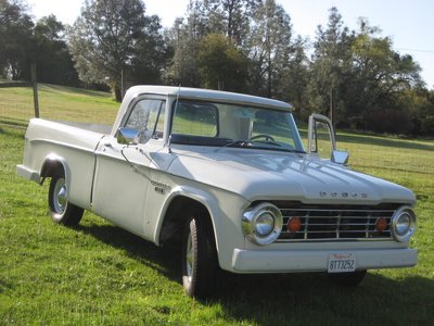

Re: Exhaust System
Hmmm, now I'm wondering if my dual exhaust that dumps in front of the rear wheels is stock. I am meeting with the original owner this weekend over beers, so I'll know a lot more then. Does the hanger look stock?

Re: Exhaust System
Sir
The only Sweptline that has the Exhaust dumping before the rear wheels is the
0ne ton and larger trucks.
The Rear of the Tail Pipe also should not extend past the Rear Bumper.
Look at the Dealer's Sales Brochure's and see what they have. This and the
Parts Book is your true guide.

Sorry to steal this post! But Gerry's truck peaked my curiosity!
Gerry, very very nice truck!
What caught my attention was the two
pictures of the rear of the truck, as I understand your truck is all original so
what is so curious to me is the lack of reverse lights? I don't know what year
your truck is (I'm guessing pre-67) so can anyone tell me when the reverse lights
became standard on our trucks?
