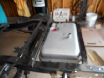

I used a chevy tank relocation kit from LMC. I took a challenger sending unit (because it was inexpensive) and replaced the resister pack on the chevy unit with the challenger one. The gauge works correctly and this is how it looks

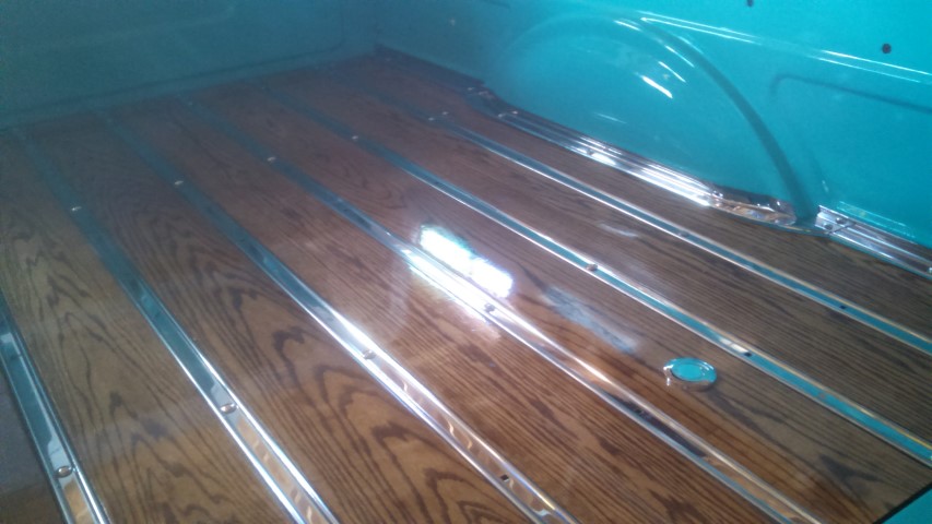

here it is finished
