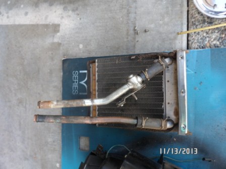

This is inside the heater box of my 68'.
Those two tubes are what stick out into the engine bay. If your pull cable marked "H" goes into the top of the heater box you should be able to see this valve through the little door of the box.
Good luck sorting things out.

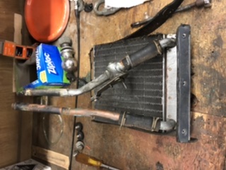

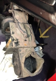

Re: Heater and Indicator Questions
The cable goes through the top of the heater box and attaches to the valve inside.
I got a new valve from Napa and put it inline with new hose. I used a plastic heater hose connector to go through the firewall. I had to grind down all the ridges on the connector but it worked perfect for me. My pictures are out of order
