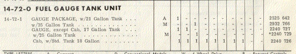

I have replaced mine on both my 64 Town Wagon and Town Panel the Mopar part number is 2240727.
The sender is listed in the parts catalog as "except cab" 17 gal tank
They can still be found but are pricey, below are two I located w,ith a google search. Make sure to ask for a picture to compare to what you have now

are you saying that these gas tanks are 17 gallon capacity? I can not find any info on that, 18 gallon though.
