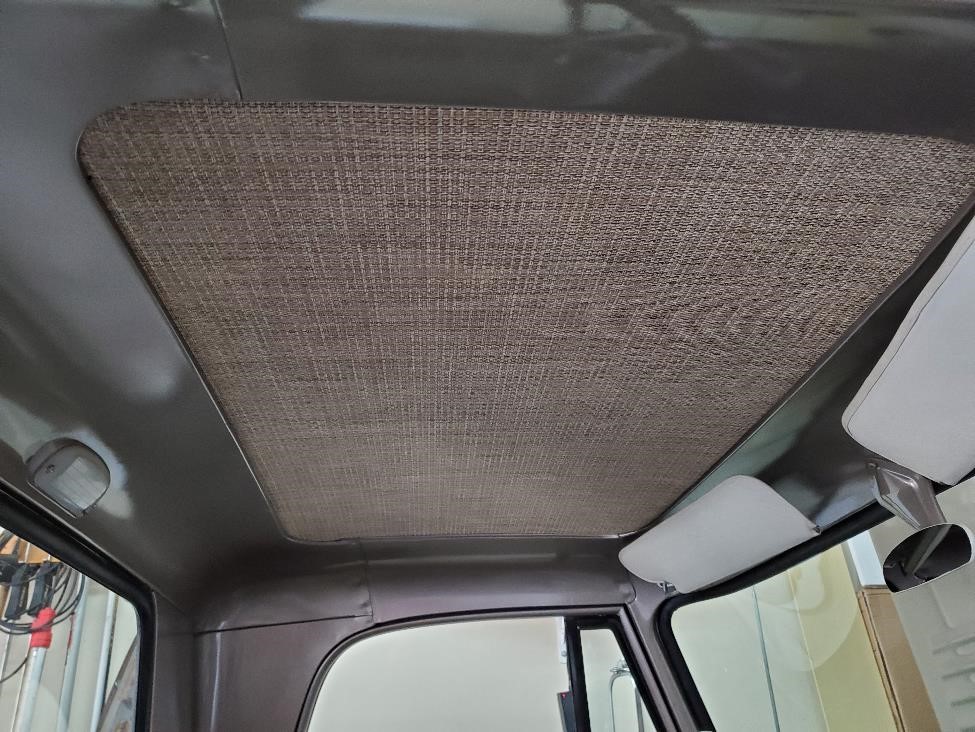

Re: Headliner material
Thanks Shawn P. for the lead on the Phifertex headliner material. Completed install today using 1/2" thick Dynamat as the backer material and 3M90 adhesive.
Mike.....
Mike.....
Let's try this picture.....New to attaching photos and compressing the file size.
Very nice job looks professional
learn somethin' every day. I didn't know an Auburn guy could do that quality of work.
Coming from an Alabama guy, thanks for the compliment, I think !!!
That Phifertex is made in right here in Tuscaloosa
