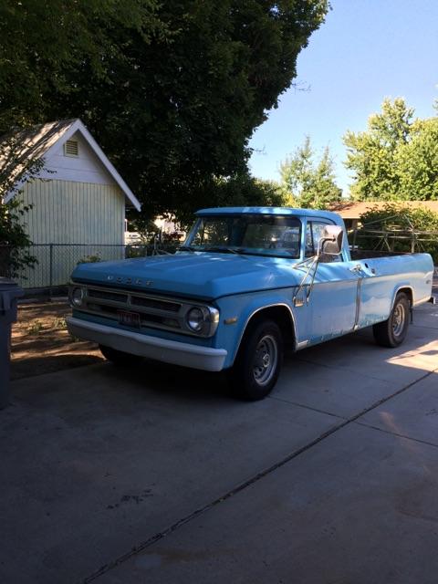

Hi, I am considering potentially buying this rig, which is for sale by a gal who was recently hit by a mini van. It obviously needs a door and probably a bed and rocker panel. That said if Im going to find a bed, then I want a short bed, so why not make it what I want. I have a W200 Power wagon short bed so I thought why not a four speed short semi hotrod too.
Has anyone done this and if so any threads on the build. I am guessing I can find the wheelbase differences easy enough. So Im going to check it out and maybe drag it home.

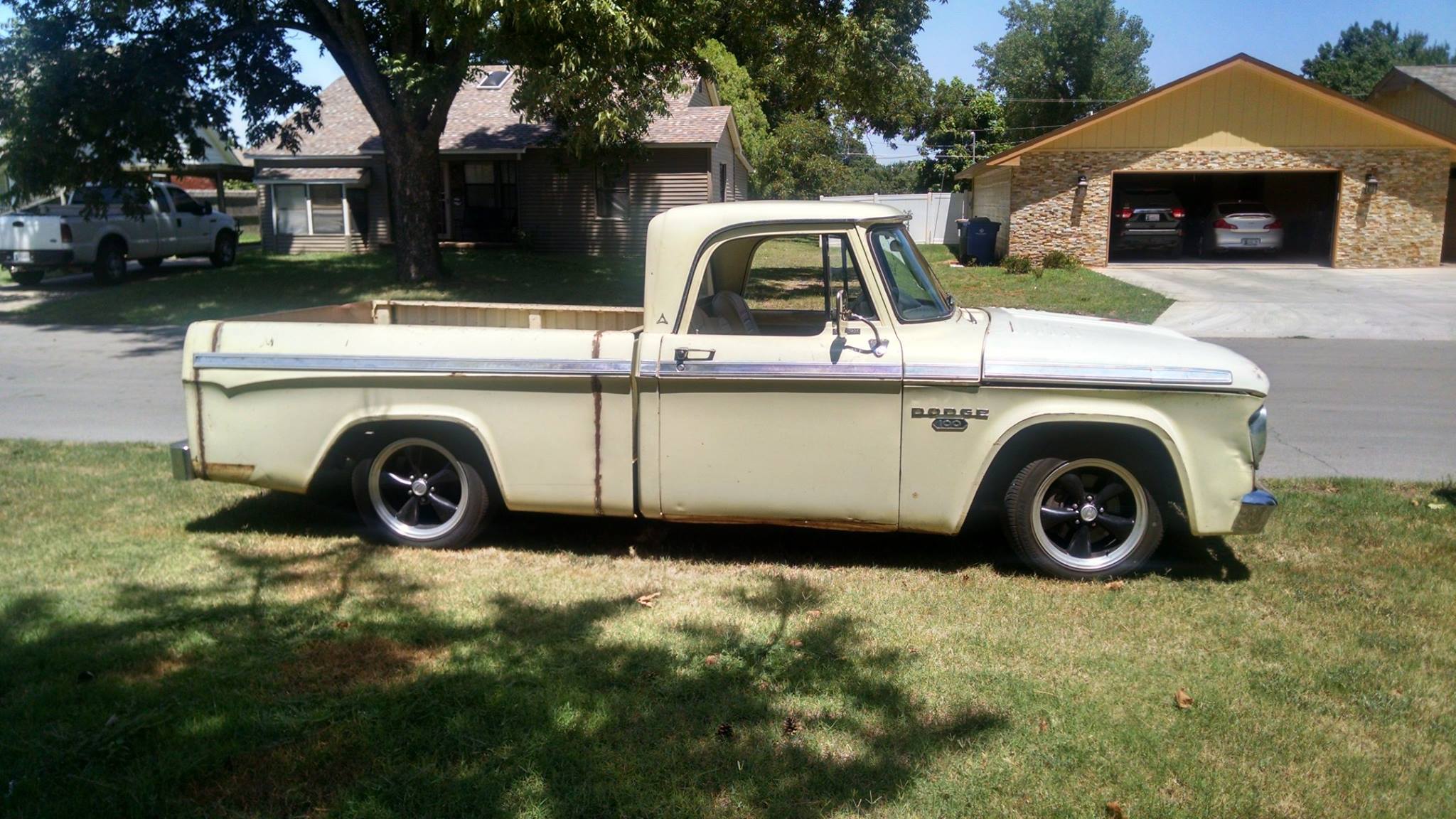

Hey Dave, this just showed up on a facebook group
https://www.facebook.com/photo.php?fbid ... =3&theater
