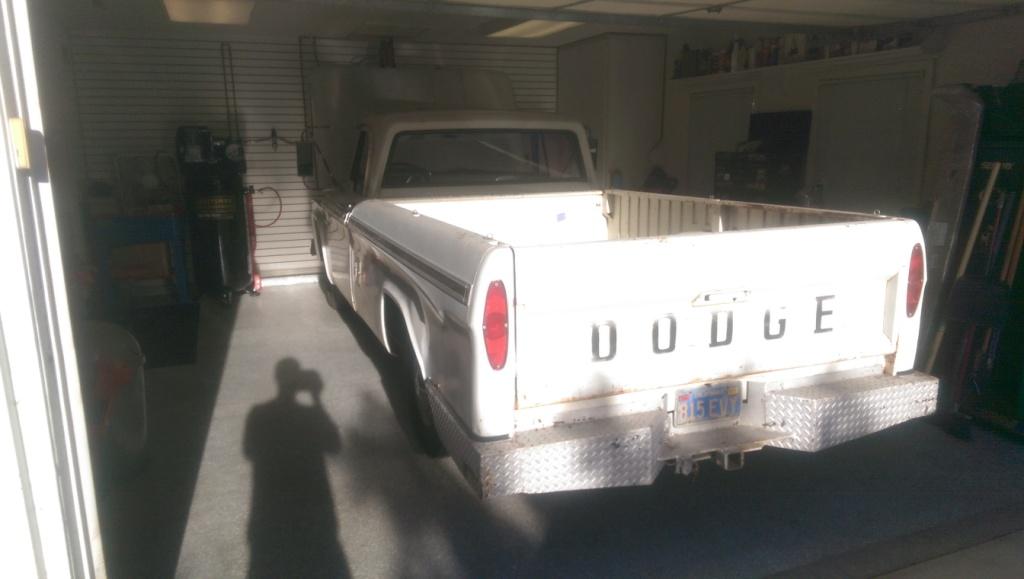

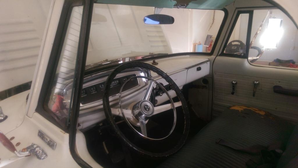

Here are a couple of pics of the engine and the truck, including the weird split-back bench seat with an armrest that looks like it came out of a Polara or Monaco.

Nice truck. your horn ring is not on the steering wheel correctly, that may cause an idle problem.
