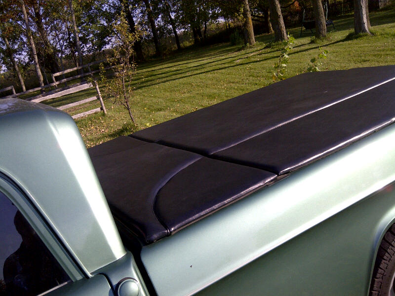

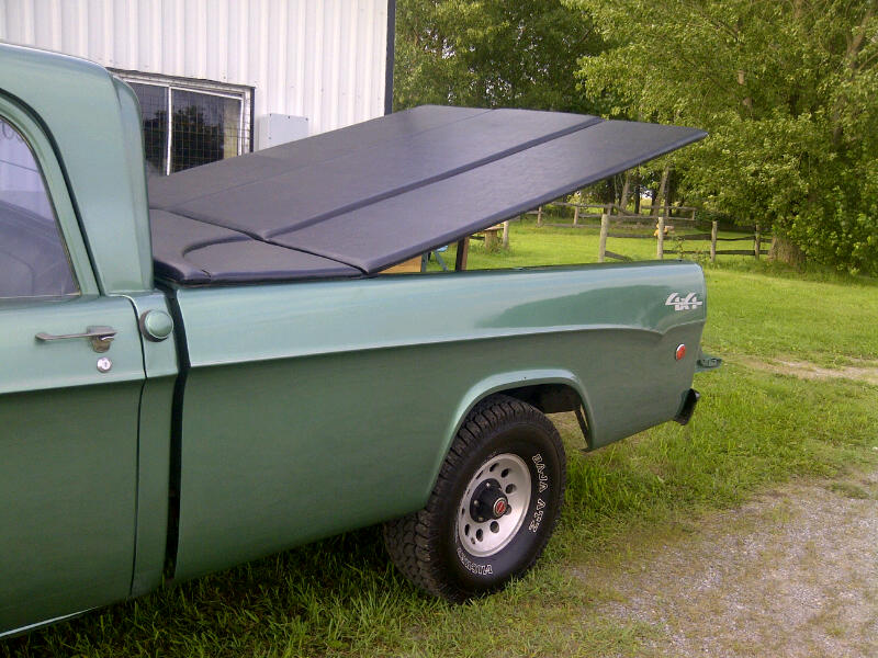

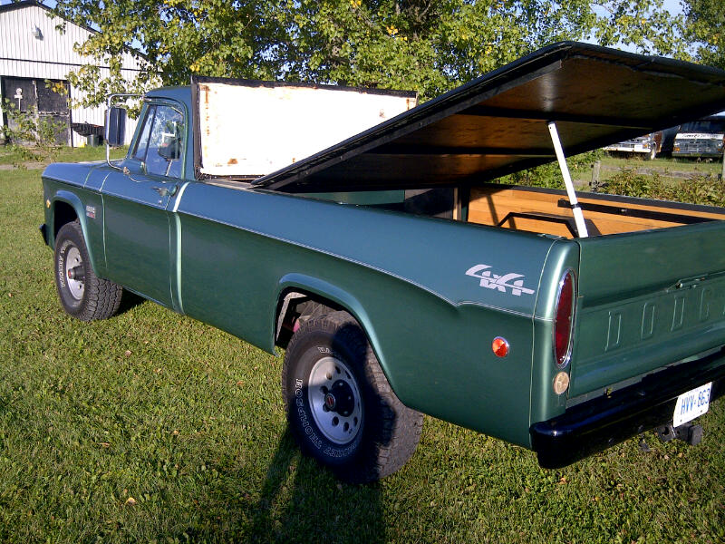

I have a hard 2 piece tonneau cover on my '69 8 foot box. It was a 1 piece when I got the truck but I couldn't reach up behind the cab. It is made of steel frame and plywood and hinged in 2 spots. Esay to slip a case of beer or cooler, tool box etc. in the back without lifting the whole lid. If anyone is interested in details let me know.

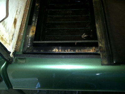

There is a piano hinge on the front of the box for the first section. The whole thing is mounted by a steel frame that is bolted to the floor at the front with 4 removable pins so the whole thing can be removed. The second piano hinge is attached to the metal frame.

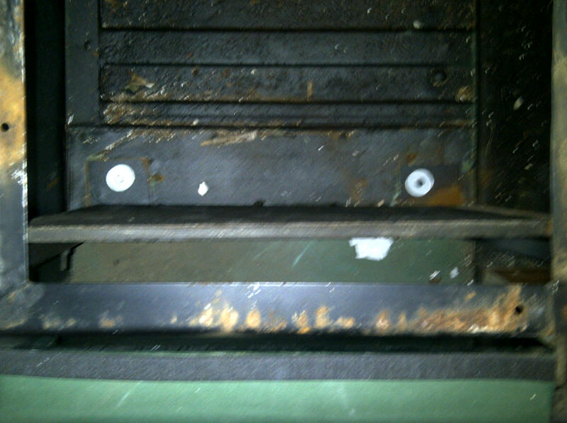

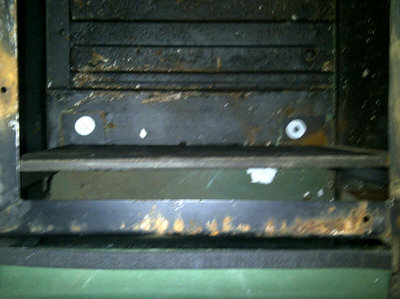

The area between the two pieces has a wide rubber strip under the hinge, it leaked a bit when I got the truck. I have added a foam self adhesive strip along the top of the box sides. You could use the foam kit you can buy for puttting on truck caps or try foam door draft stop insulation from local hardware store.

Rubber strip and foam to prevent leaks
