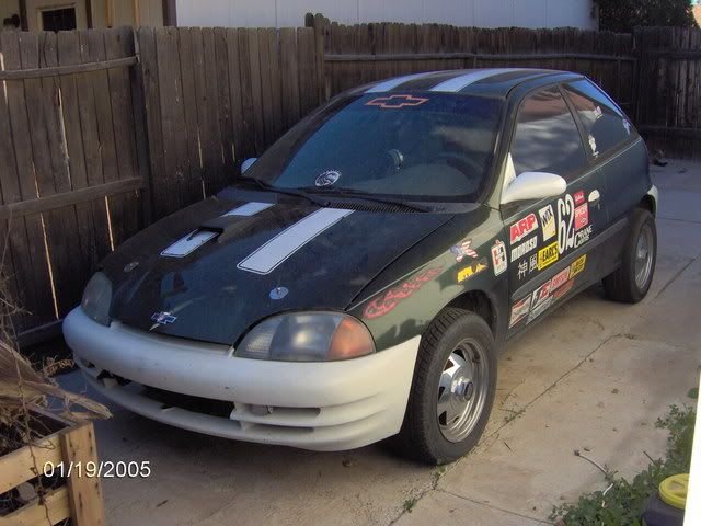

I had a 1999 Metro with the screamin' 1.0...Really good on gas, very poor on performance. I cut the exhuast off right after the cat, put on a 27" cherry bomb and a 90 degree, and ran the exhaust out in front of the rear passenger side tire. I also took off the stock air cleaner and put on an edelbrock triangular-shaped foam-element filters with a hole-in-the-hood scoop right above it. After that it was loud, poor on performance, and average on gas. Oh, and the stickers added almost 900 rwhp.
