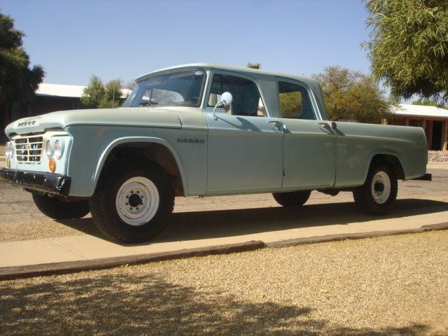

They are out there. I would try to stay away from the chevy ones. I had them on my old truck and had to run spacers on the front because they were hitting my tie rods. I have 16" dodge wheels on my truck now. Just don't go to big of a tire or they will rub too. I have 265-75-16 on this truck and they rub pretty bad. I'm think 235-75-16 would be perfect
1963 Crewcab Cummins
