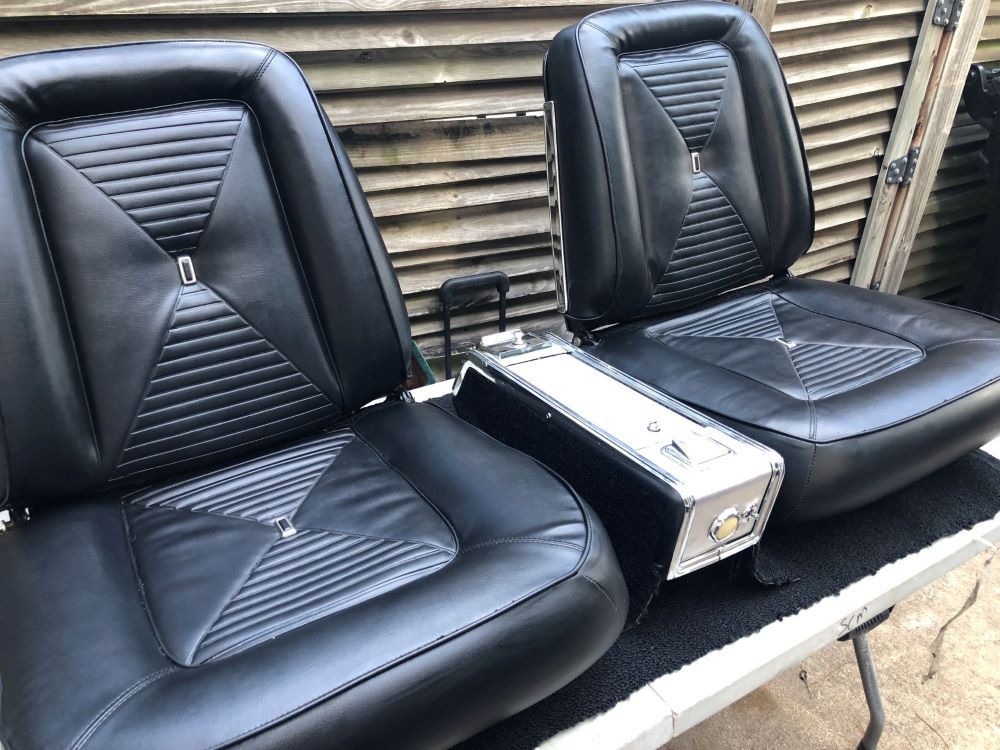

Here's mine done by Rick's custom upholstery. https://ricksupholstery.com/ He is known for chevy but, has the dodge pattern and frame. The console is custom but, I also have a stock one in same marine vinyl. Craig Edit...this is like the adventurer 70/71.

Those are Adventurer seats, NOT the Dart seats you were asking about. They are secured to a framework that sits in the standard seat brackets.
