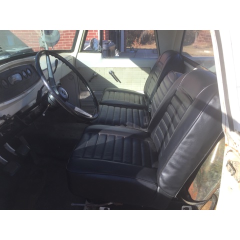

I got a set of buddy buckets in sad shape for $50 3 years ago. They were from a 1968 and fit perfectly Into my 1964 without any modification. I had them recovered for $750.

In my opinion, Sweptline era bucket seats are nearly impossible to find. I think between salvage yards & forums, I have about $350 or so in my seats. I recovered the buddy seat but was lucky to find good used seats to make a nice set. I sold the excess parts.

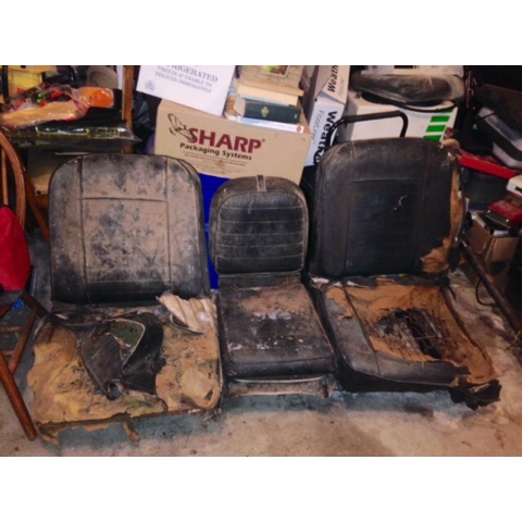

Posts: 7529
Re: Buddy buclets
Ive sold and seen hammered sets like those above sell for $300+
