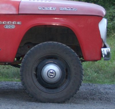

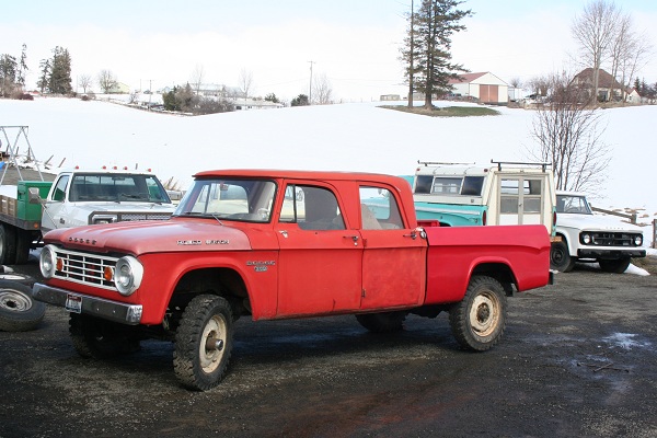

Yes and yes! :Thumbsup goodyear G171s work well (though spendy) @ 33 1/2" tall I would pursue them if the wheels aren't too much. Most tires are very expensive in 19.5,but they work well on sweptlines and LAST.

Thanks guys, I'm not sure if $40 a rim for 5 rims is a good deal or not, but I think I'm going for it. The extra height on the tiresshould help tame the 4:88's a little. Your truck looks good with the rims and tires on it.
