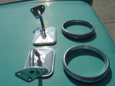

How much was it? Looks pretty good to me.
Re: Chrome powder coat
This is a different angle and thanks, the reason I was wanting to see a different angle is I wanted to see if their was a shine to them, it looks like their is almost a shine, have you seen a shine come off them?
