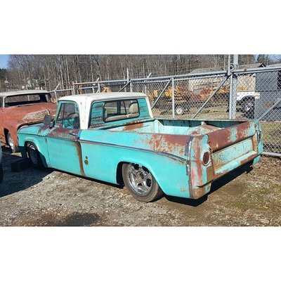

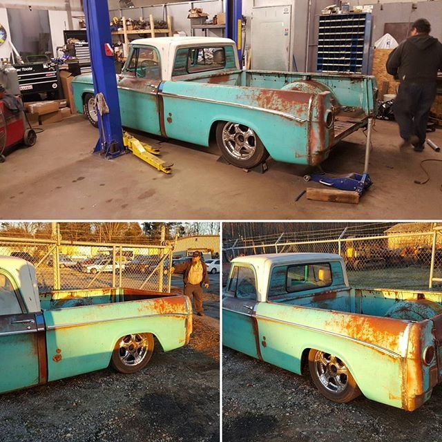

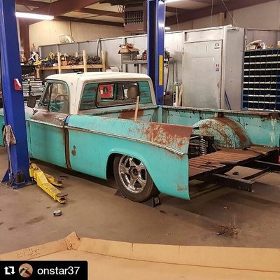

This is what I may do to my 63 eventually. Much more dificult with mid 65 up. This makes it a med bed lwb. Looks good to me. Shop that did this is out of the mid west some where. I can find out the name if any one is interested.

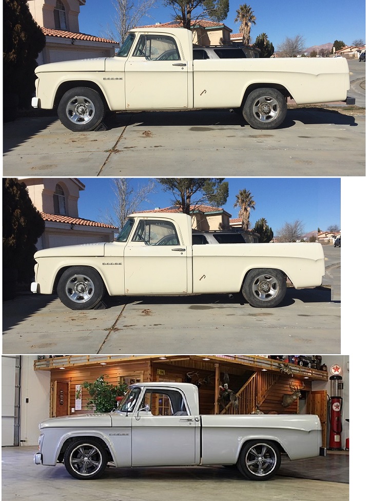

Here is a photshop i did with my 63 with the chop done compared to original and an actual short wide.

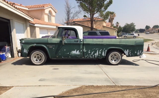

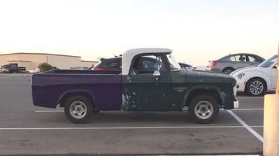

Here is what I did with my 68.
