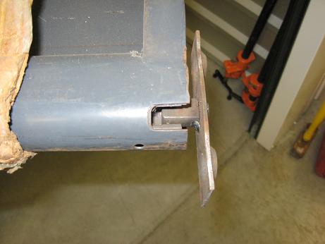

There was discussion awhile back about the easy-off tailgate option for the Camper Special Dodge offered for the 70 or 71 trucks. I came across a once in a lifetime opportunity back in the mid-90's. I was able to purchase a NOS factory tailgate. The tailgate that I thought I was purchasing was the tailgate that has the Dodge name stamped into it. When the tailgate arrived, I was estatic. When I looked at it, the Dodge name was not there and there was a notch on the bottom right-hand corner. I said "Great, wrong tailgate". After researching, I realized that it was a Camper Special easy-off tailgate. Then I sat down with a celebratory beer in one hand and a shot in the other. I thought to myself, "There is a Dodge Truck God". After further research, I was able to purchase the right-hand pivot bushing. I hope these pictures help out. You all can see what a NOS easy-off tailgate looks like.

Wow, is that cool, or what? Wouldnt be too hard to add that to a non-easy-off tailgate. \

By just what I see, someone with a little bit of fab skills could reproduce that. It looks like just a section of thick wall tubing with a notch cut out of it and inserted into the tailgate. The corresponding tab attached to the bed would probably be the harder of the two pieces to make. But I'd bet that someone could make a few bucks on 'em if they repopped them. :thinking :study

On the newer trucks they are slightly different, at least mine is. The holes on the sides of the tailgate are the same size, one just has a slot at a 45* angle. The pivots are also the same diameter but one is thin enough to fit through the slot. Something like that may be even easier to make because it wouldn't require the thick wall tubing. You could just modify the existing tailgate.

Yes, that might work better. If you took one side's pivot pin (for lack of a better way to describe it), and cut a small part of it off, just enough to make it oblong, say, 1/2" narrower, with the correct sized notch in the existing gate, it's an easy win. :thinking :study

I think I am going to have to get medieval in order to remove the tailgate
from my donor shortbed. This helps me know where and how to whack!
