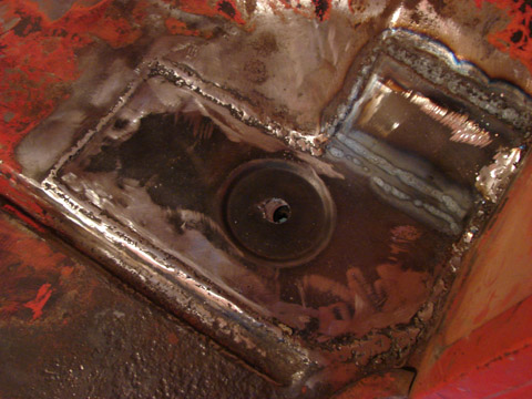

If you do end up needing patches im going to start making them.
Here is what they look like.

Nice! I'll PM you for details. I'm here in cali so shipping shouldnt be bad.

Sweet !! I may be getting in touch with you ! :salut

Great, good to see that these will help you guys out!
