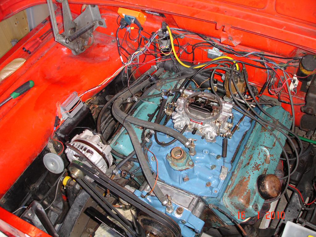

I spent uncounted hours to clean and to remove the rust out of the runners and plenums. To make the runners rust free I took slices of coarse sandpaper /w a thick cord at each end. At least the runners are rust free and looking like polished.

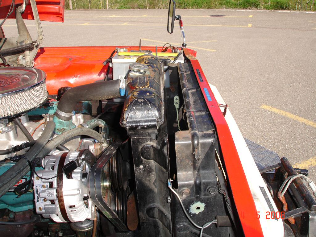

what are you doing in the top pic? moving your rad? care to eleborate more on this?

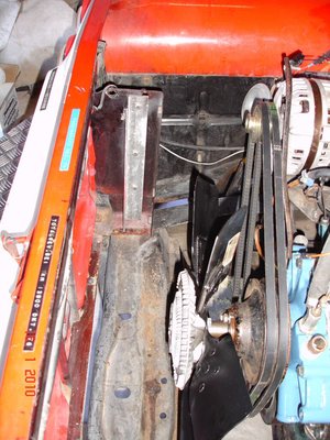

The radiator I removed because I had to remove the water pump and the timing case due to a water leak at a bolt. So I replaced the gaskets (of course after cleaning) and assembled the whole stuff. All the screws (intake, timing case, water pump) I only torqued by hand - no tool. After 24 hours I put the full torque (required) to every screw and filled in the cooling fluid.
This photo I put into this thread because once a friend (in another forum) was asking how I shifted the radiator to make room for a fan /w a fluid (thermal) clutch. Might be that some has an interest about how to shift the rad either.

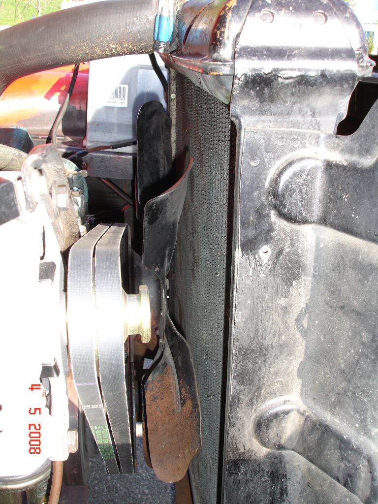

i have a clutch fan and didnt have to move the radiator(?) i used a clutch fan from a late new yorker, bolted right on in place of the solid 4 blade fan. plenty of clearance, much more radical cooling at low speeds. i wonder why you have clearance problems?

Thanks a lot for your information about your truck. Originally my truck had a (
) solid 7 blade fan /w a 3 row rad. The clearance was less than an inch between the rad surface and the solid fan. So there was no chance to mount a visco clutch (a 4 wd version for Dodge Trucks from Rockauto.com) between the waterpump and the rad.

i see. your rad fits in a lot different than my two row. you dont have much room at all in there.
