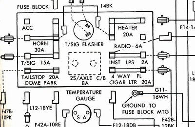

Anyway, for my next task, I want to check to see that I've got the properly rated Fuses in each Fuse Box slot. I know I've seen this somewhere, but for the life of me I can't remember where to find this info. Anyone know? Or have a copy of the Vehicle Manual, Service Manual, etc.

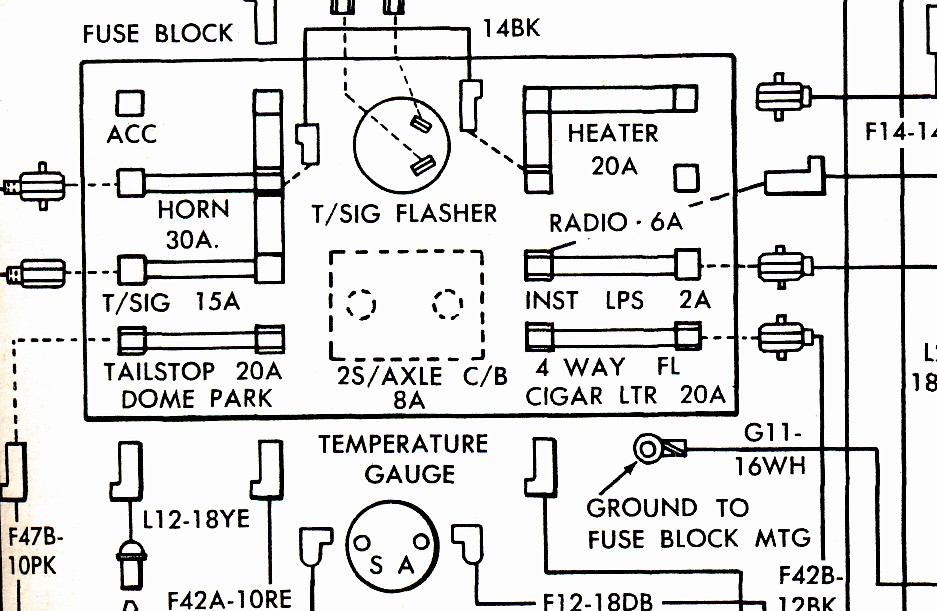

Fuse block '68 D100 FSM
Post by nytemuvr »
