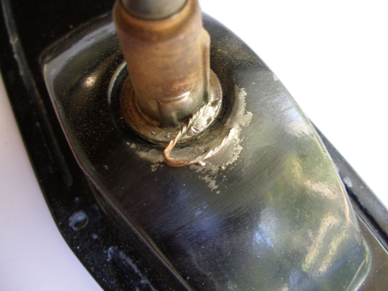

On a Sweptline the taillight sockets are crimped on to the housings and can develop corrosion between the socket and housing and that's why I suggested conneting the ground wire to the socket instead of the housing.

Glad you got it fixed. Bad grounds seem to e a common problem on Sweptlines. Here's how I fixed the taillight housing that I mentioned in a previous post.
