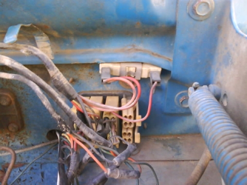

Hello all,
I am installing an Ignitor in the truck and am unsure of which side of the ballast resistor is the ignition side and which is the coil side. One side has a single red wire and the other side has both a red and an orange wire. Also, where do I splice the Ignitor wire in? All pertinent replies greatly appreciated.

First thing you need to determine is which side is powered by the key. Get you a test light, unplug both sides from the resistor and then test your connection by turning the ignition switch to run.

the instructions for this models says to not bypass the ballast resistor if the vehicle came equipped with one.
for mine it states the wire from the ignition switch to the ballast resistor is the same wire that also goes to the red wire on the Ignitor. the other side of the ballast resistor is what connects to the positive side of the coil. the negative side of the coil is where the black wire from the Ignitor is hooked up.

Thanks for the replies. I got the wiring figured out and got the truck started. Seems like a whole different machine. Only problem is it was pinging pretty good under mid to high load. I was in the process of setting the timing (my first attempt at this EVER) and now I am unable to get the truck to start back up. Battery died really quick. I'm assuming that trying to start the truck when the timing is not set uses more juice?
