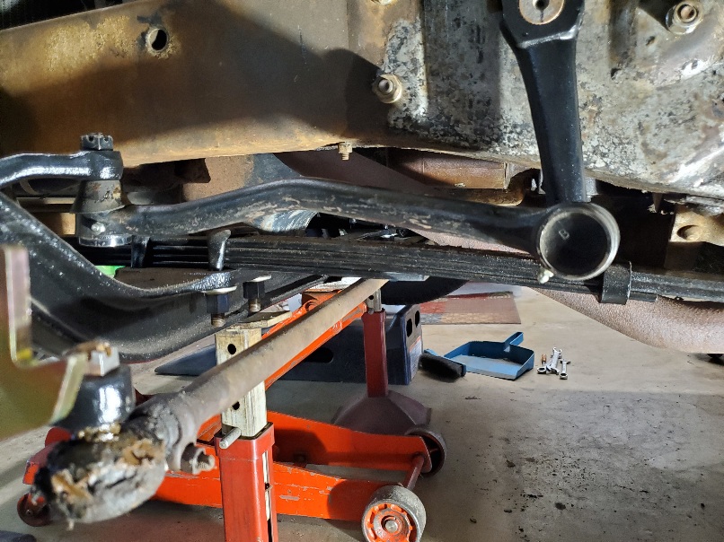

This is with the wheels straight ahead
That looks kind of dangerous. :pale

So here it is with the W pitman arm and weight on axle.
