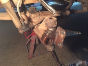

D200 crew cab king pin help
Post by Oshork67 »
I'm trying to remove my spindles and king pins it looks like there I a pin pressed in the front of the spindle retaining the king pin. The back has a open hole I'm assuming I need to drive the pin out to remove the king pin. The large hole is where the keyed steering arm bolts in. Any help would be appreciated.

Although this diagram is for the D400 axle, it might help you. :idea :Thumbsup
http://www.sweptline.org/suspension63_68/02-08.gif

That does help thanks I guess a little time with a punch and BFH is in order :Thumbsup

I took my crew axle to a machine shop that also had the proper reamer to do both top /bottom at the same time.
