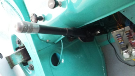

Re: emergency brake?
Post by kurt »
It looks like this
1965 D200 Crew 5.9L MPFI/A518
Posts: 3066
66 has handle on left upper kick panel. They fall down when severe rust in area or removed due to being inoperative and previous owner too lazy to fix it.
