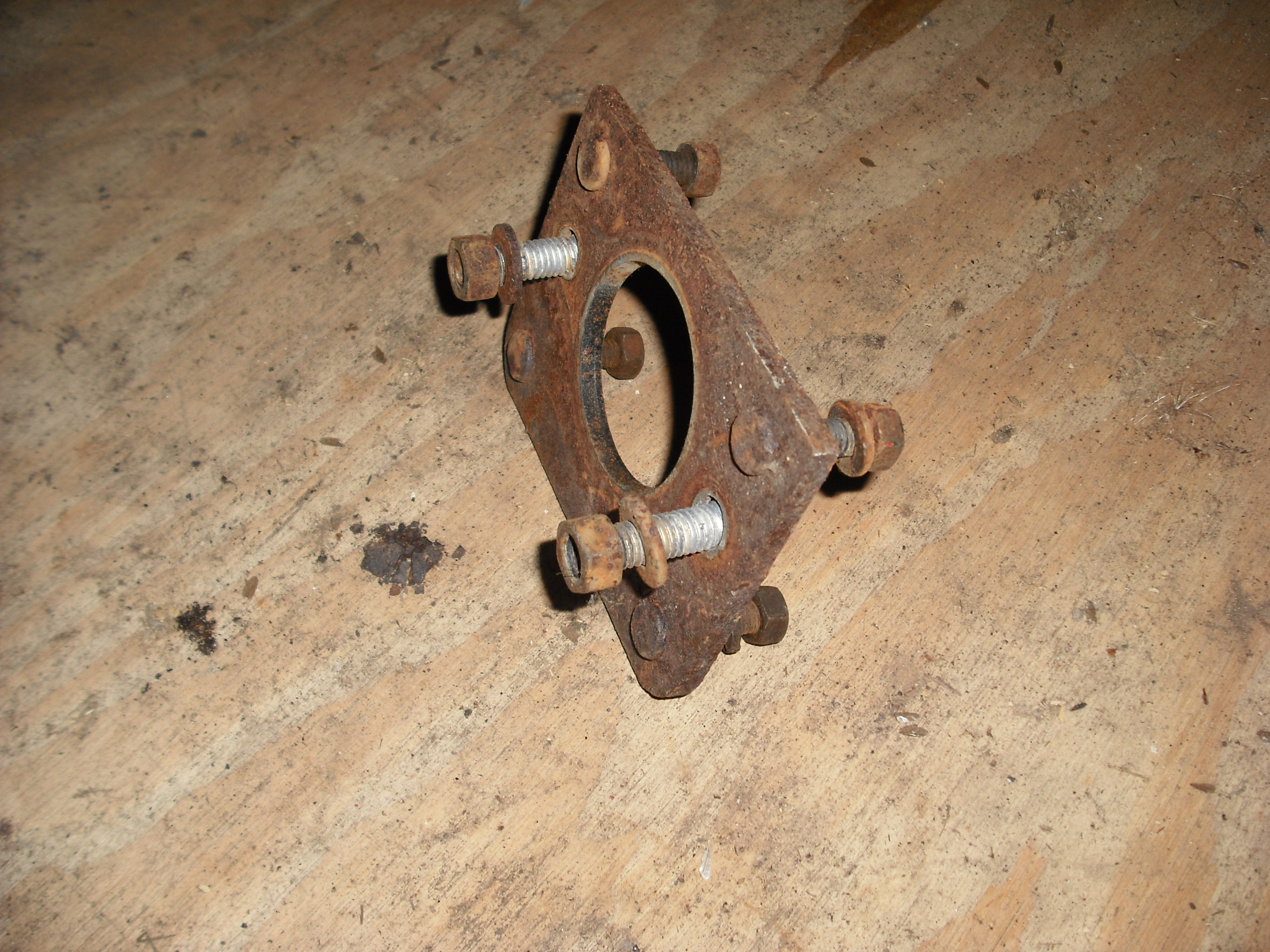

Re: Convert master cylinder to dual reservoir unit
Fire Wall Plate For Two Bolt Master Cylinder
Here's the plate for the '67 and '68 two bolt dual
reservoir master cylinder.

I really appreciate everyone's input. I bought a MS for a '72 D100 & the bore size is 1 1/32" & I need 1 1/8" so that the plunger on the truck will fit in the end of the M/S. Either the master cylinders that I was able to find at local auto parts stores are 2 bolt design with 1 1/8" bore or 4 bolt with 1 1/32". I can't seem to locate a dual reservoir, 4 bolt with the larger 1 1/8" bore. It seems my options are to exchange the MS from the '72 D100 for an original single reservoir MC for my 1965 D200 & just not convert to a dual reservoir, locate a smaller diameter plunger that will fit the '72 D100 MS or locate a firewall plate off a '67 or '68 D200. Does anyone have any other suggestions or do you have a firewall plate I could purchase or know where I could get one? Any help would be appreciated!
