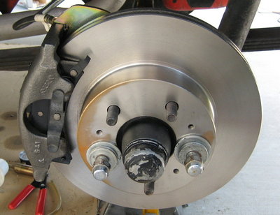

I just finished the disc brake setup from Scarebird. Haven't driven it much, just up
and down the street to seat the pads, but it definitely feels better. :Thumbsup
They really did their homework putting these parts together. Very well executed. :salut
I'll report back as soon as I get some miles on it.

Yes I used what Scarebird had on their list. It went together fairly well.
I'm amazed that they figured out all the different parts to work together.
I have to find all my receipts but I think I spent around $700. But, this also
includes $100 core charge for the calipers that I need to find some old ones
to get some of my money back. I also just bought all my parts from my local NAPA,
and got their premium rotors and pads, etc. I'm sure you could save some money by
shopping around or buying online. In addition I replaced the outer bearings which you
may not have to do.
All in all I think it's a good setup. If it stops as good as it looks, I'll be all set.
-Ed

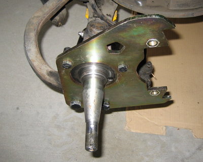

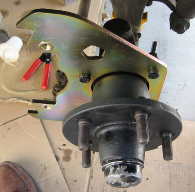

That picture helps alot. I haven't installed my conversion yet but from the looks of it you use the existing hub/spindle on your pickup, correct? Also what is everyone using for a porportional valve (front/back brake bias valve)?

Yes I used the existing hub and spindle.
So far I haven't used a proportioning valve. I still have to make some hard
stops to see if I need one. But so far it's working fine as is.

In case they might help here's a couple more pics.
I have some more but they are too big to load. I have to load a program
to reduce them.
