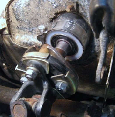

Here's the UHMW insert with a 6204-2RS bearing and stainless band clamp.

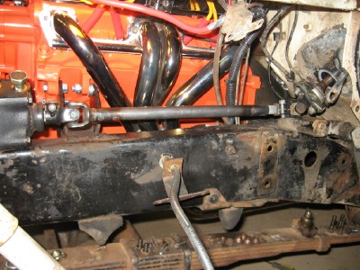

Tonight I made up the steering shaft between the column and the box. I still have to take it back out, smooth the welds, bead blast it, & paint it.
Here is the shaft in place. I plug welded it to the splined section at the rear, and plug welded it and face welded it to the u-joint at the front. It's not going anywhere.
I used the splined section plus about 2" of the '90 shaft (top), and the u-joint from the '01. They were joined using 7/8 ODx.125" wall DOM tubing bored to 11/16 ID.
An overhead view of the new steering shaft.
This shows the support bearing and UHMW insert I machined to hold the bearing in the column. I slit the column tube so the band clamp would clamp down around the insert and bearing, and a dab of Loctite keeps the shaft from spinning in the bearing.

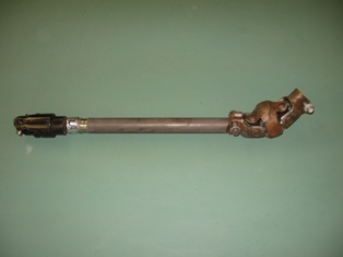

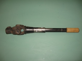

Here's the newest (and last) version of the steering shaft; finally got it installed last week.

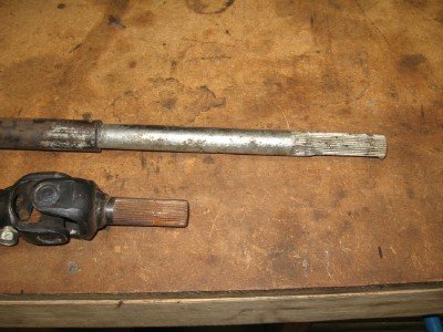

'98 Ford Econoline 150 steering shaft before it fell under the saw. Note the cute little double-Cardan u-joint; stock column angle is a little sharp for a single u-joint, so this looked like a perfect solution. I almost got away with simply clamping the 3/4"-36 spline Ford front u-joint to the 11/16"-36 spline on the Nissan box, but it put the joint in a bind.

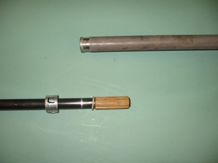

Nissan u-joint with internally splined tube. This u-joint attaches to the steering box.
Nissan U-joint.jpg (19.73 KiB) Viewed 678 times
Splined sections of the Ford shaft. Male spline is hard rubber or soft plastic; absorbs vibration and allows flex between the cab/chassis.
Splined sections.jpg (21.17 KiB) Viewed 678 times
Nissan joint section cut to length, Ford male shaft section cut to length and pressed into the Nissan joint, ready for plug welding.
Shaft before plug welding.jpg (20.82 KiB) Viewed 678 times

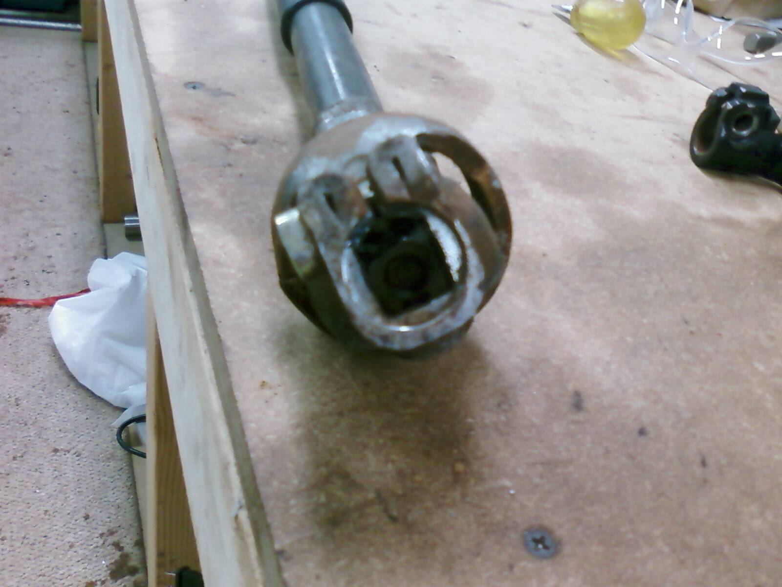

Profile of the hole in the end of the Ford double-Cardan u-joint. I machined the end of the stock column shaft to match.

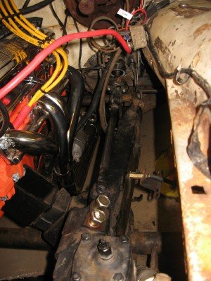

$15 pick-a-part pump from a 1986 D-150. Pump had to be shimmed forward about 3/16"; I think it's due to a difference in the pulley mounting between years; the '71 pulley is all one piece.
Hose arrangement; the pressure hose is further away from the header than it appears. 16mm/JIC adapter screwed right into the pump discharge port. I had the hose guy clock the ends 90 deg. apart. Return hose is standard stuff, utilized one of the Nissan banjo fittings and 3-4" of the tube.
