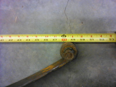

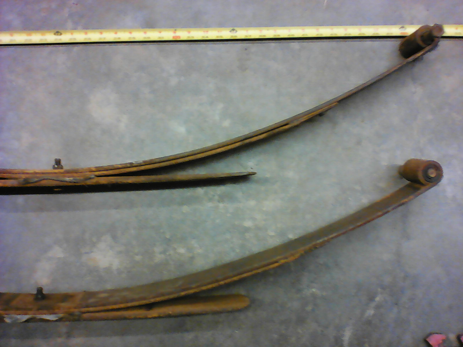

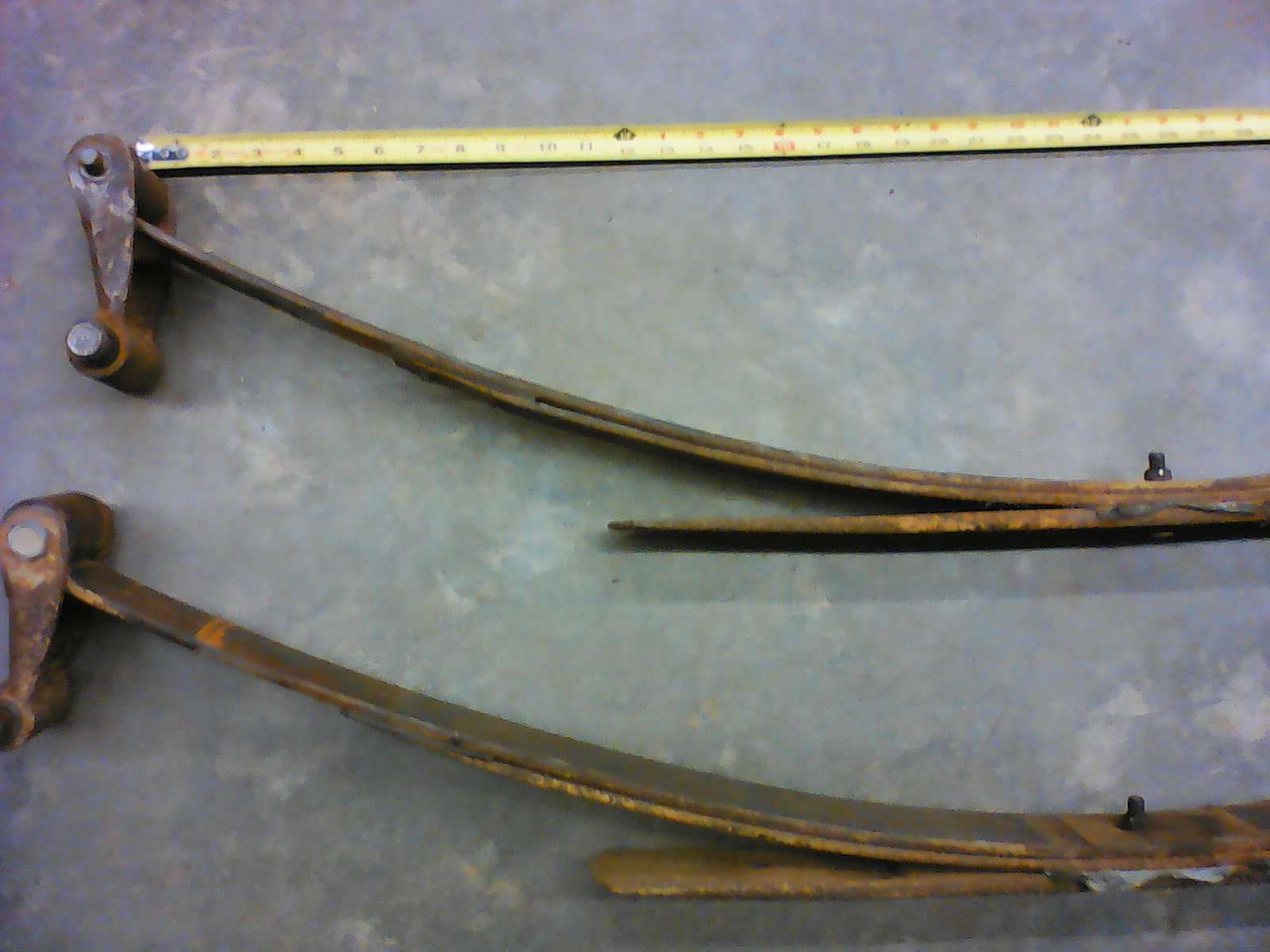

Re: Lowering options?
howard37,
I don't know for sure if my truck had 4 or 5 leaf springs because the previous owner already had the truck lowered when I bought it. Here are some pictures of my rear spring packs. I sold the whole front axle assembly the other day, so I don't have any pic's of the spring's. sorry.
Thank you very much, for info and pics...

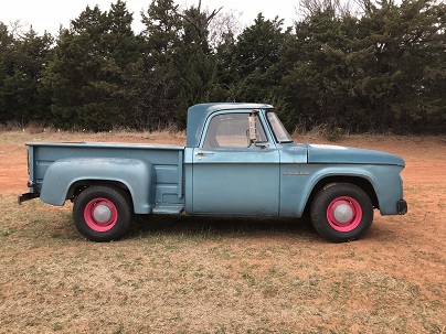

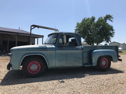

New here, but just finished lowering a 63 D100 with a 3" axle from Sid and longer shackles and flipped spring hangers on the rear. Ended up with a 3" front and 3-1/2" rear drop. I didn't mess with any leaves in the springs and can document everything I did in a "tech" thread here if anyone is interested. Truck rode like stock, no interferences anywhere, and sat good when done. If it were mine, I might have gone a little lower, but the owner wanted it to sit like it does.
Before: After:
Before: After:
