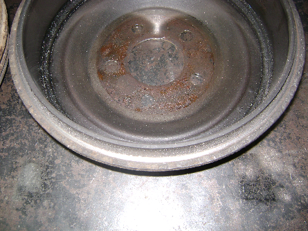

So the truck is running good. A few annoying issues Ill address one at a time, but it works pretty good for now.
I noticed a rubbing noise in the back, so I investigated and found the problem. Pictures are below. The rearend has a casting number of 2881489, and a quick google search shows this to be a "medium" duty 8-3/4" chrysler, with a 1-7/8" tapered stem pinion out of something from 69-74. The noise was one of the brake drums rubbing against the inside flange (I think that's the name of it). The drums are different, so I am assuming the one rubbing is probably wrong, like maybe off of a different year. Is this correct?
Also, the park brake just wont work. It slows the wheels down if they are spinning, but it wont hold the truck from rolling. I added the Lokar handle (its in the build thread for Isaacs truck) but the handle is about the same length as the factory one, so the cable pull ratio should be about the same. I might have the park brake parts installed incorrectly. I looked for a diagram, but I couldnt find a good one. Does anyone know where I can find a good one?
I still have a lot of work to do on the brakes, because they just dont work as well as I think they should. They stop the truck, but if someone put me in a bad situation, I'm going to hit them.

hard to tell from pic but looks like the leading shoe is on the back
front shoe should be the smaller one

Ditto Nutz's comment on the brake shoes. The shoe with the shorter length lining (primary) is installed in the front position. The shoe with the longer lining (secondary) is installed in the rear. This is for the "self-energizing" action. Google Bendix self-energizing action for more info.
Also, I don't see an automatic adjuster cable. I can't tell from the photo if the automatic adjuster arm is in place. You'll need both to provide the automatic adjustment and to prevent the star wheel adjuster from loosening w/road vibration.
The stock emergency brake handle is adjustable. It is adjusted by turning the knob at the end of the handle. Sometimes the knob locks up or becomes stiff from lack of lubricant, but it doesn't usually take much to free them up so they can easily be turned by hand. I'm not familiar with the aftermarket Lokar handle that you utilized.
The factory service manual has excellent illustrations of each brake shoe/wheel assembly as well as the emergency brake system.
Also, measure the diameter and width of the brake shoes and compare it to the specifications in the factory service manual. You'll want to be sure they didn't become smaller with the rear axle change. I saw from glancing at the photo bucket that you went to disc brakes up front. If you haven't already done so, you'll need to add a proportioning valve in the rear brake hydraulic circuit. You'll probably want to go with an adjustable, so you can adjust it to balance the braking power between front and rear.
As the rear axle has been changed, you'll want to take a look at the pinion angle and make sure the U-joint is not going to encounter the limit of it's movement as the rear axle travels from full up to full down, of the suspension.

Good catch on the shoes being backwards. I didnt see that at all. Only the passenger side was wrong, the drivers side was okay.
I changed the shoes around, and re-adjusted them. I also put the other new parts in, that I neglected to put in when I put the brakes on. Also one of the springs I had replaced with a new one just didnt seem to be shaped right, so I cleaned up the old one and put it back on.
But the brakes are still not good. The truck stops, but I cant lock any wheels up. The pedal has what I think is good pressure, and it feels tight. I can push it so hard I hear a squeak from under the hood, which I assume is fluid going through the MC. But they are just weak.
After reading about the problem (hard pedal/weak brakes) on a few hotrod forums, it very well could be one of a few issues. 1) the booster is too small or it isnt getting enough vacuum. and 2) the master cylinder might be too big. I bought a conversion kit specifically for 67 D-100, but it was one of those universal type kits, so take that with a grain of salt. It was from Pirate 4x4 I think, but it listed the 67 D100 and I bought the one for front disc brakes. I assume they were expecting a poly 318 with a single barrel carb, so the vacuum would probably be higher than in this LA 318 with a 4-bbl. It appears to be an 8" booster, so I might have to get a 10" or a 12". Someone mentioned a dual diaphram. Ill have to check the vacuum at idle. Also the squeak seems to be when fluid is passing through the master, and the hotrod guys say the MC might be too big. Im not sure what the piston diameter is, so Ill have to look into that. It might have been sized for the larger trucks, with bigger brakes. This brake kit has been an issue altogether. Not as bad as the mustang 2 suspension, but this thing is fighting me.
Someone mentioned it could be the design on the modern metric disc brake calipers, and them being a mismatch to a standard PV-1/2 combo valve. Im not sure. Ill start with the vacuum and look at the booster. If that doesnt work, Ill look at re-sizing the master. If that doesnt work, Im not really sure where to go.

Re: Need expert brake help
the other thing that could be a problem is the brake pads them self
the lining might be too hard
if run into this problem with euro cars i work on
if the pads are too hard you need a lot more effort to stop until you heat into them
ceramic pads last long but have no bite
and organic pad will have more bite
Another thing I need to check is the proportioning valve. Its a PV-2, so it could be tripped to the front or the back, and not providing pressure to both. And Ill also have to check the vacuum. I think I read online that it needs 18" of vacuum at idle, so Ill look at that, but its going to be a few weeks. Ill update if there is a change.
So I did a little checking. I started by hitting the brakes when the truck was cold, then starting it, and trying again. The pedal feels the same in both situations. I checked for vacuum at the booster, and it has it going in (im not sure how much, Im going to get a gauge), and there is a valve that is working on the booster. I moved the vacuum hose to another port on the manifold, and even replaced the hose with a better, stiffer hose to eliminate the possibility of it collapsing under vacuum, which I havent seen, but just in case. Still works the same. Then it occured to me, they feel like manual brakes. It feels like the pedal on the F100, which is manual. Again, the truck stops, but it wont lock up a wheel.
Im going to get a vacuum gauge and see what its making. The internet says it should be 18" minimum. Then Ill go from there. So far, I think my booster isnt working. Its either undersized, or Im not making enough vacuum. We will see.
