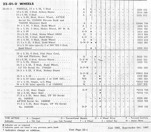

Re: 1964 wheels
The parts book has a few more sizes, like 17 (for export) and 17.5 (use as required). I do not see any 16.5s but you never know. I've also seen SERT numbers for wheels.

Re: 1964 wheels
Sorry, I didn't realize my attachment would look so blurry. Click on the attachment and then enlarge it.

Re: 1964 wheels
what is it you are trying to show us. They are no 16.5 wheels in that list as we have already determined.
Re: 1964 wheels
Tell him to quit swearing.powerwagon54 wrote: ↑Tue Sep 18, 2018 12:27 pmno mention of any other sizes, right. I have a customer swearing that his 64 came with 10.00 x 16.5 wheels on a D200. By my books they were not even offered until 69.
a '69. The 16 [lock ring], 17.5 one piece and 19.5 one piece were probably the choices, as they're
listed in my '62 catalog....
