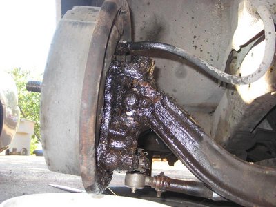

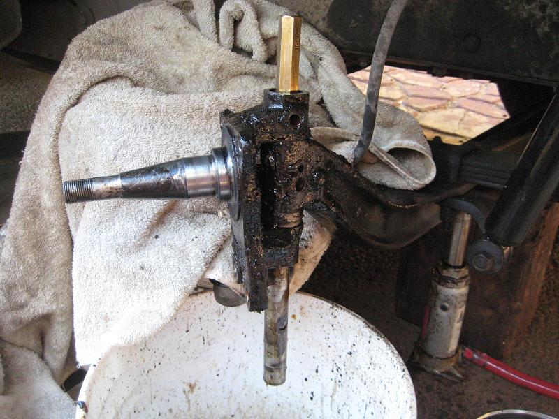

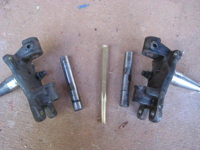

Here are a few shots of the very fun king pin replacement vacation.... View from the bottom up in order....
old parts and bent punch
glad thats over...
glad thats over...
finally got it apart
Picture 647.jpg (32.54 KiB) Viewed 2132 times
almost out....
almost out....
let the pleasure begin......
Re: removing king pins
So theres no machining needed on the axle, just the spindles. Doesn't look bad. Thanks!! :salut
