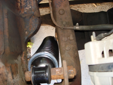

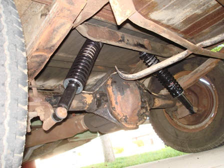

I have some sagging leaf springs, so I decided to try this as a cheaper alternative to buying new leaf springs!
Monroe coil over shocks. I used the same part number that is listed for the rear on the front as well. I have about an 1/8" clearance between the frame and coil.
I got them at http://www.autobarn.com for $145 and free shipping!

Guys-
So far so good! The truck rides real nice. Still feels like a 3/4 Ton truck should, but these are really eating up most of the big bumps better than the old worn standards!
The part number I used is Monroe 58484. They are for 2wd, and are listed for 1967, but they obviously fit earlier years!
