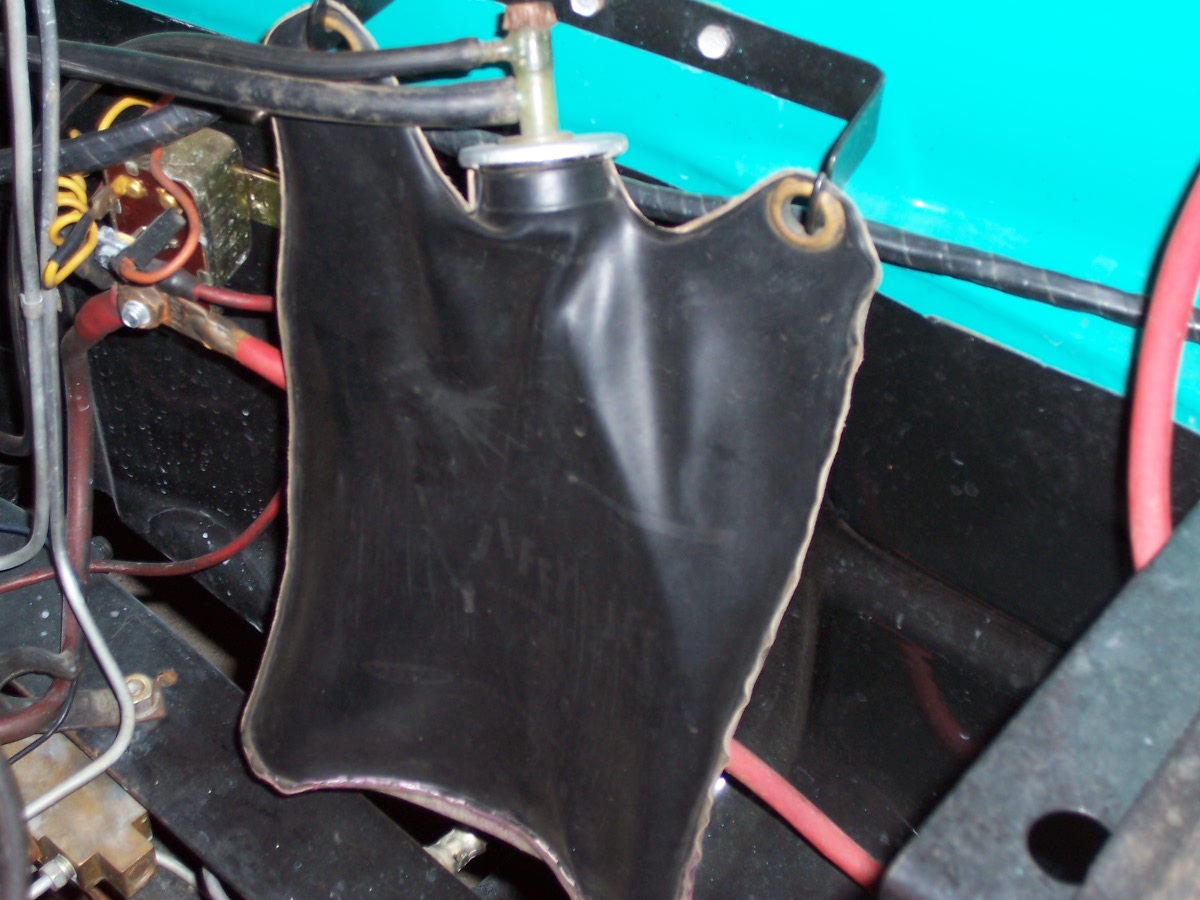

If you have the 4 terminal starter relay for automatic transmissions, you still can use that with the standard transmission. You only have to make a ground wire and attach that to the 4th terminal. SEE the YELLOW wire on my relay? That is a ground wire to the terminal. Just make up a jumper wire and ground that terminal. I DO forget which letter it is. Maybe I can get a better picture if you can't understand this one.

I should've taken a better picture of mine that shows my "grounded" tang...
