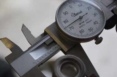

Here is the part number of what I got and the first pic of the inside diameter of the rocker pedestal.

Here are the measurements of the new and old rocker shafts

Re: Poly rocker arm shaft questions
I went to the NAPA site and ran part numbers for 318 rocker arm shafts
for '61, '63, '65, '71, '72 & '75. There was no part number for '61. For all other
years, part number RS-626 came up. :thinking :study
John :2cents

I'm gonna make a trip to my local machine shop and see what they recommend. I can either spend money modding the new shafts to work OR send the originals to rockerarms.com and have them reconditioned. :thinking

rockerarms.com is going to refurb my shafts and rocker arms. They will also add in allen type set screws with jam nuts for valve lash adjusting......I like that!
Local machine shop confirmed the thoughts on the RS-626 being for later LA engines only. Guys with poly engines, make sure you keep all your rocker arm stuff together and don't count on being able to find parts for the valve train!!!
