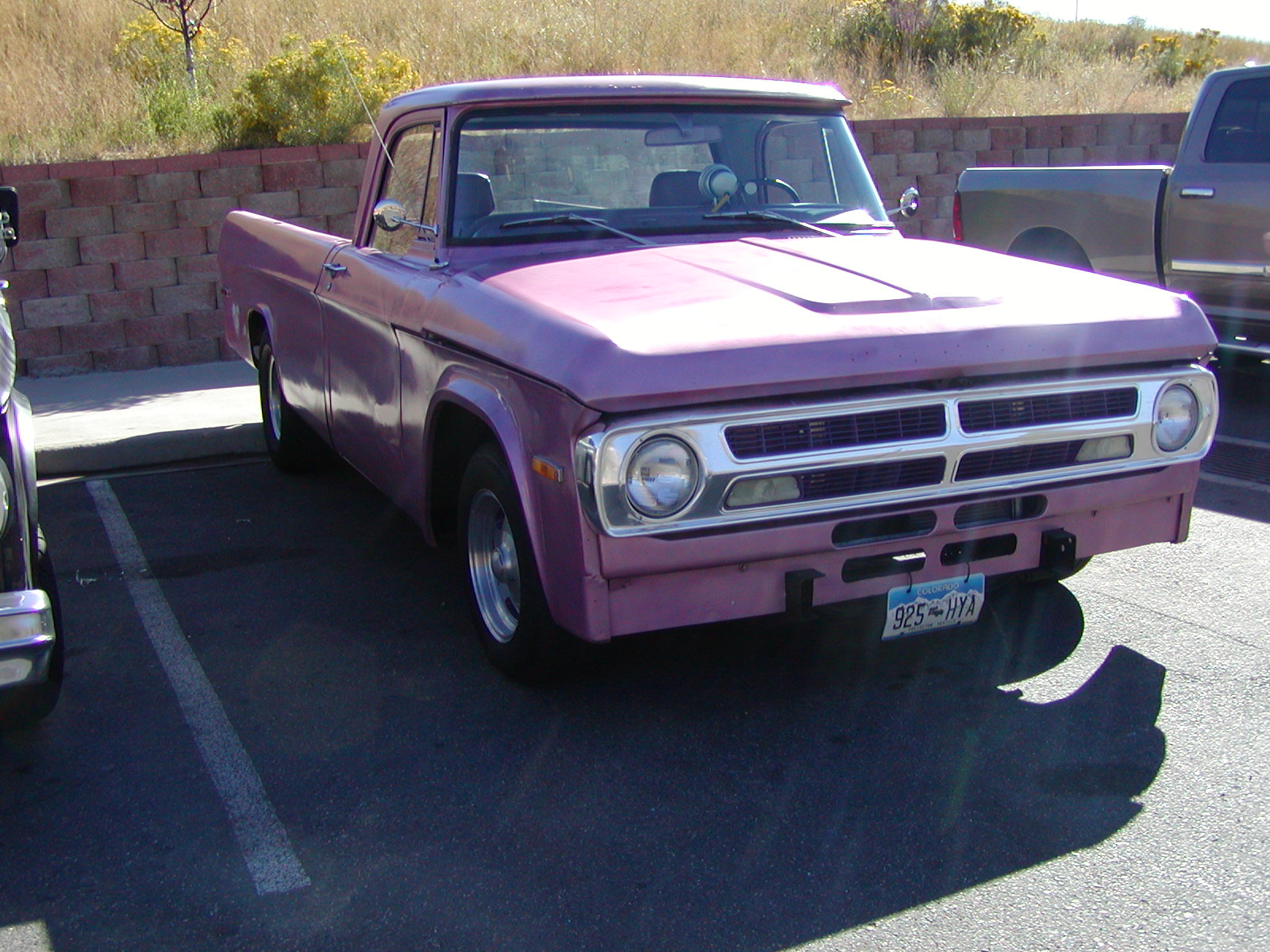

Yes, I realize that, but at the same time depending on the postioning of the Roll Cage I'm looking at going a little more as you can see from this picture my truck has been lightened up years ago, and will also be doing moreright now I'm comfortable with the ET would be around mid 13's, depending on the NHRA rules on the Roll bar I'm considering pushing towards the 10'squickd100 wrote:Robin; If you're looking for high 11's low 12's you don't need a roller for your 440. If you take a look at the old MP recs for those times and even loosely follow them you should meet your goals. The cheapest and easiest performance mod is weight reduction, take everything off the truck you can get away with. Try and get it down below 3500 lbs. The second thing is chassis, get it to hook consistantly, clamp the front spring segments together or install a set of SS springs. If you use the original springs also use an adjustable pinion snubber, also get some slicks or very good street tires.
For the price of a roller cam you can get a fantanstic convertor and have money left in your pocket. The biggest performance gain I've was my first high stall convertor. A good 10" TA will stall around 3800-4000rpm. If you've never had one before you may want to put a set of depends on the first time you nail the throttle. Dave
