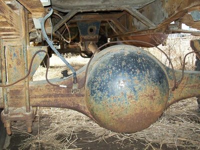

Re: dana 70 help
Time to upgrade!
17,000# capacity
Rockwell 6.8 ratio17,000# capacity

Re: dana 70 help
712edf wrote:Time to upgrade!
Rockwell 6.8 ratio
17,000# capacity
I've got a couple of those rears and it's hard to get the 61 D-500 over 55mph,
would not be too bad if you had 50" tires,
but then it would need atleast a 440 for power.
