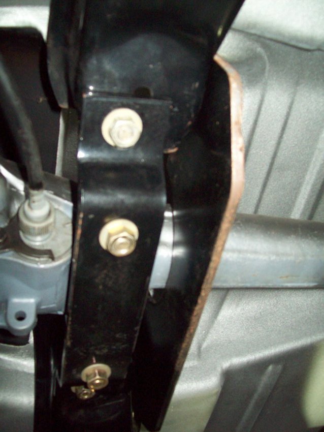

Are you handy with a welder? I think the only solution is to make your own.
Hooker claims to make some that fit the '67 and '68 but they 100% do not fit. The manual trans cross member is right in the way.
This cross member is what is really in your way. This is the Hooker header in the photo but it is actually several inches away from touching the head.
I cut most of the cross member out with an angle grinder.
Once the manual cross member is out of the way then you can get the headers in but the collector is still pointed at the automatic cross member. I talked with the folks at Hooker (I'd like to put the bottom of my boot in the face of their technician
) and they say I'm having trouble with the auto cross member because I have a RB rather than a B block but I don't know if I buy it. But this is what I had to do to get around the auto cross member.

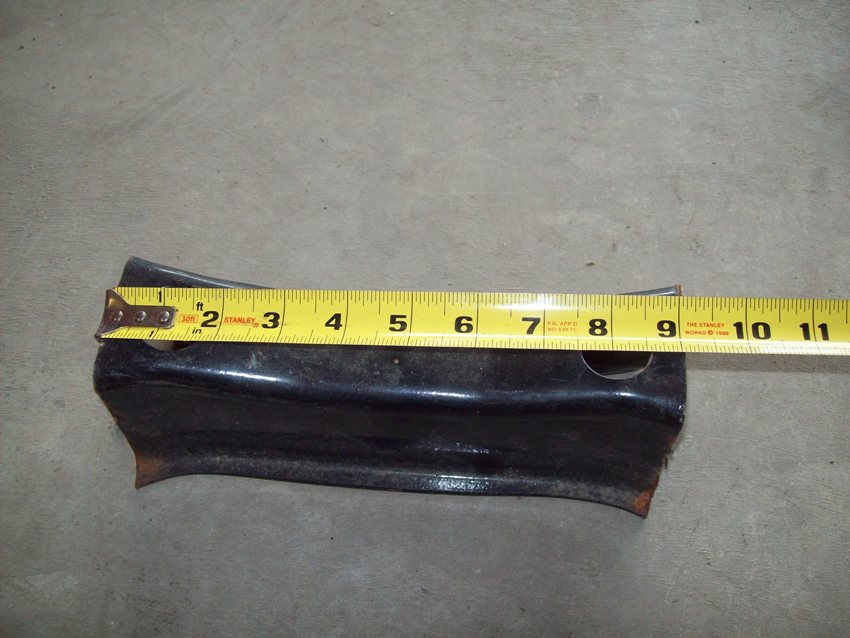

I had the same problem, first I cut 9" out of the crossmember. Then I just flipped everything upside down , I also made a extra support plate and bolted it to C/M. The trans. stayed at the same height. I have 3" exhaust and it has no clearance problems, here are a few pics. so you can get an idea.
